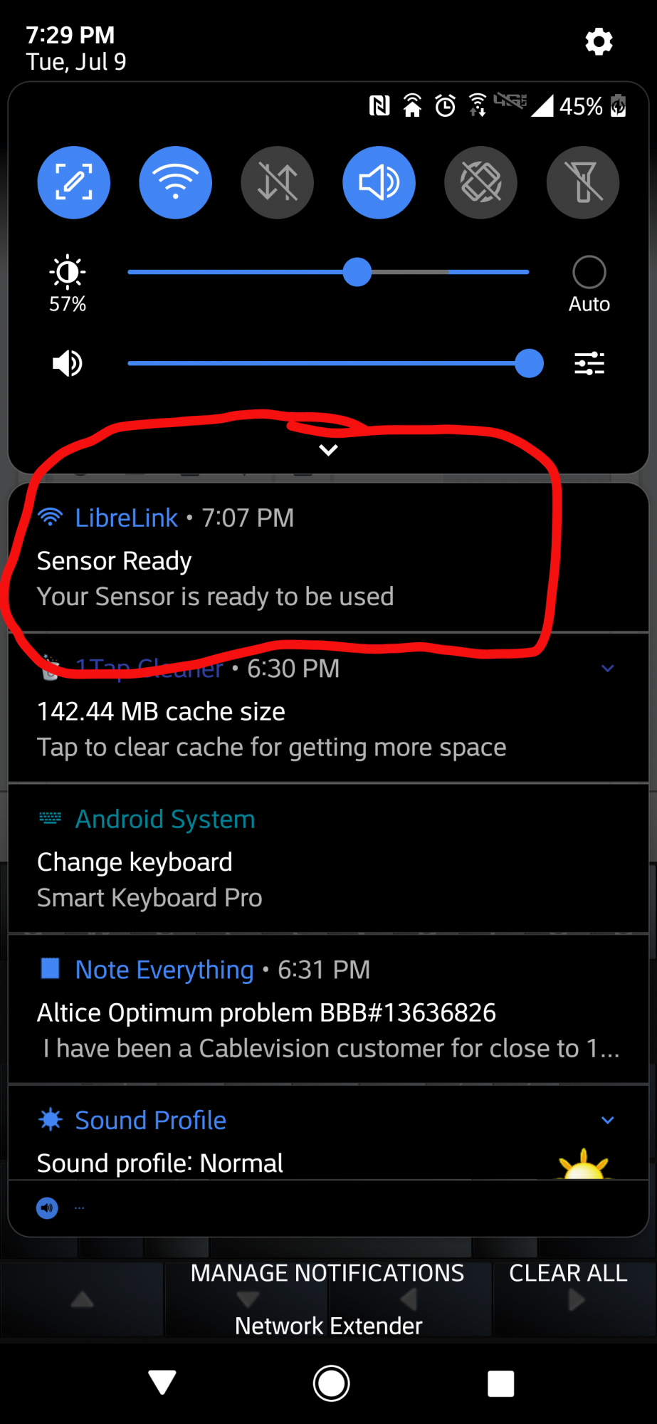

I use the NFC chip to read a blood sugar sensor for my diabetes. For the past month there was always a message in the notification area saying it was ready to use. For some unknown reason, the message is no longer there, even though the chip is still working normally. Does anyone have any ideas what could have happened and how to get that back ? I checked, under notifications, the app that uses the chip and all the settings are turned on. I restarted my phone and cleared the phones cache under settings and shutting the phone off but still no status. ¯\_(ツ)_/¯

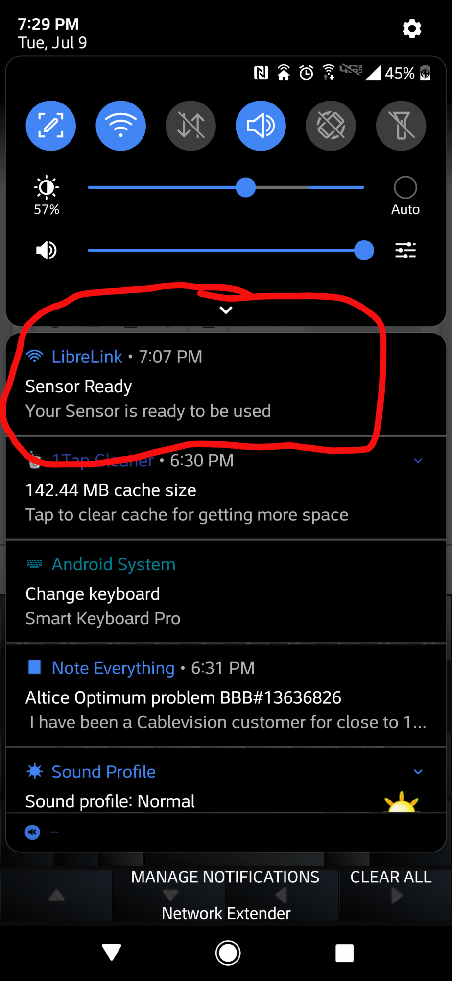

I got tired of LG not knowing about the NFC chip and the Freestyle people not replying to my emails. I uninstalled the app and reinstalled it. I lost all the information stored in the app, but I got the status of the chip back. Thanks to everyone that helped.
I got tired of LG not knowing about the NFC chip and the Freestyle people not replying to my emails. I uninstalled the app and reinstalled it. I lost all the information stored in the app, but I got the status of the chip back. Thanks to everyone that helped.View attachment 143005

BTW: it was the Freestyle app causing the problem. Once I installed an update, the problem was gone.
