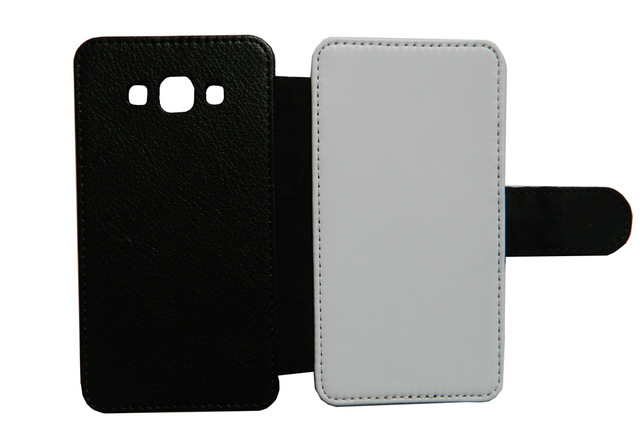

No, not at all, it's just a blank flip case I had a custom picture printend on by an online shop (see attached image).
The image showcases a A5 (2015) case, I couldn't find the same image for A5 (2016) but it's basically the same with minor changes on the layout of the camera.

So the magnetic portion is on the flip tab? Still, it could be either of those scenarios causing this. Of course there's always the poltergeist theory. ;)
Really, don't worry about it and enjoy your case and phone.
