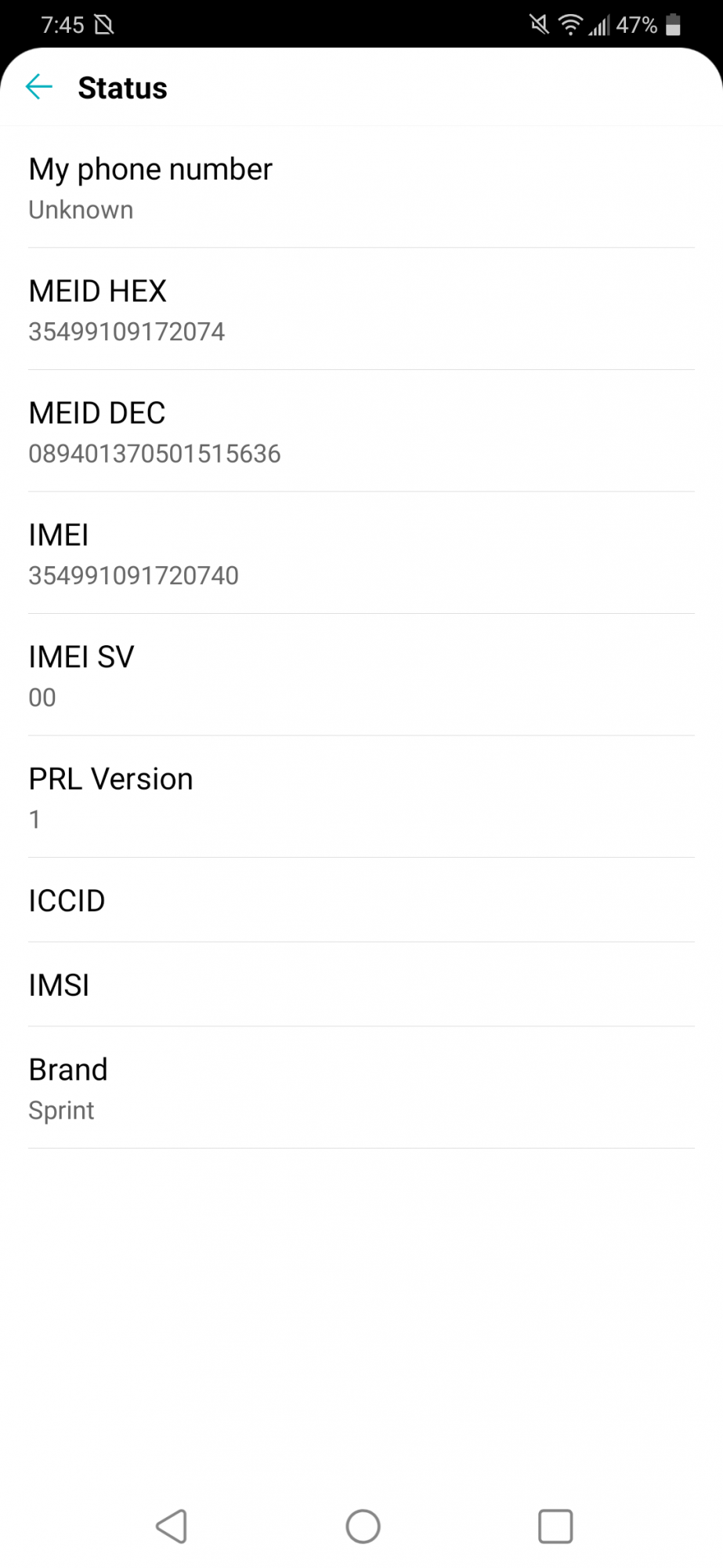

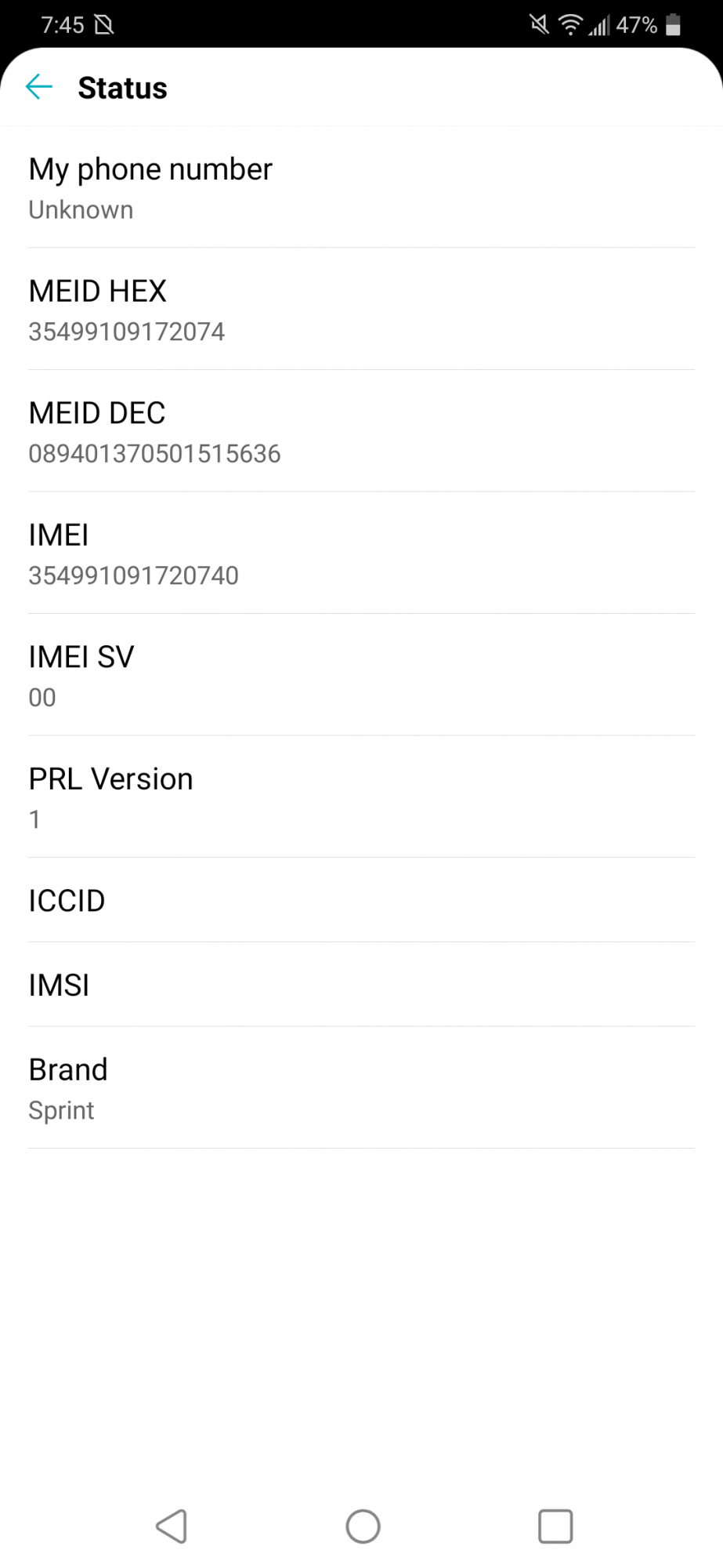

Hey there! Bought LG G7 ThinQ on the secondary market. Everything is fine except one — there is no mobile data on it. I can call or text, I can use Wi-Fi, but mobile data doesn't work.
I tried to add a new APN, but there is no way to do it in settings (Screenshots). Also, I tried the "Add APN" apk, but it didn't help me too.
Then I tried doing a factory reset, resetting network settings, but it still doesn't work.
What should I try before rooting the device and reflashing it?[GALLERY=media, 1715]Screenshot_20220825-140405 by andryuhaagressor posted Aug 25, 2022 at 2:10 PM[/GALLERY][GALLERY=media, 1714]Screenshot_20220825-140413 by andryuhaagressor posted Aug 25, 2022 at 2:10 PM[/GALLERY]
So it has both IMEI and MEID, so I guess it supports both GSM and CDMA

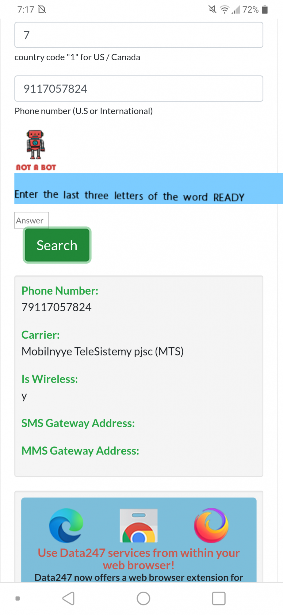

It's Russian operator called MTS. I used their official APN settings from their website
