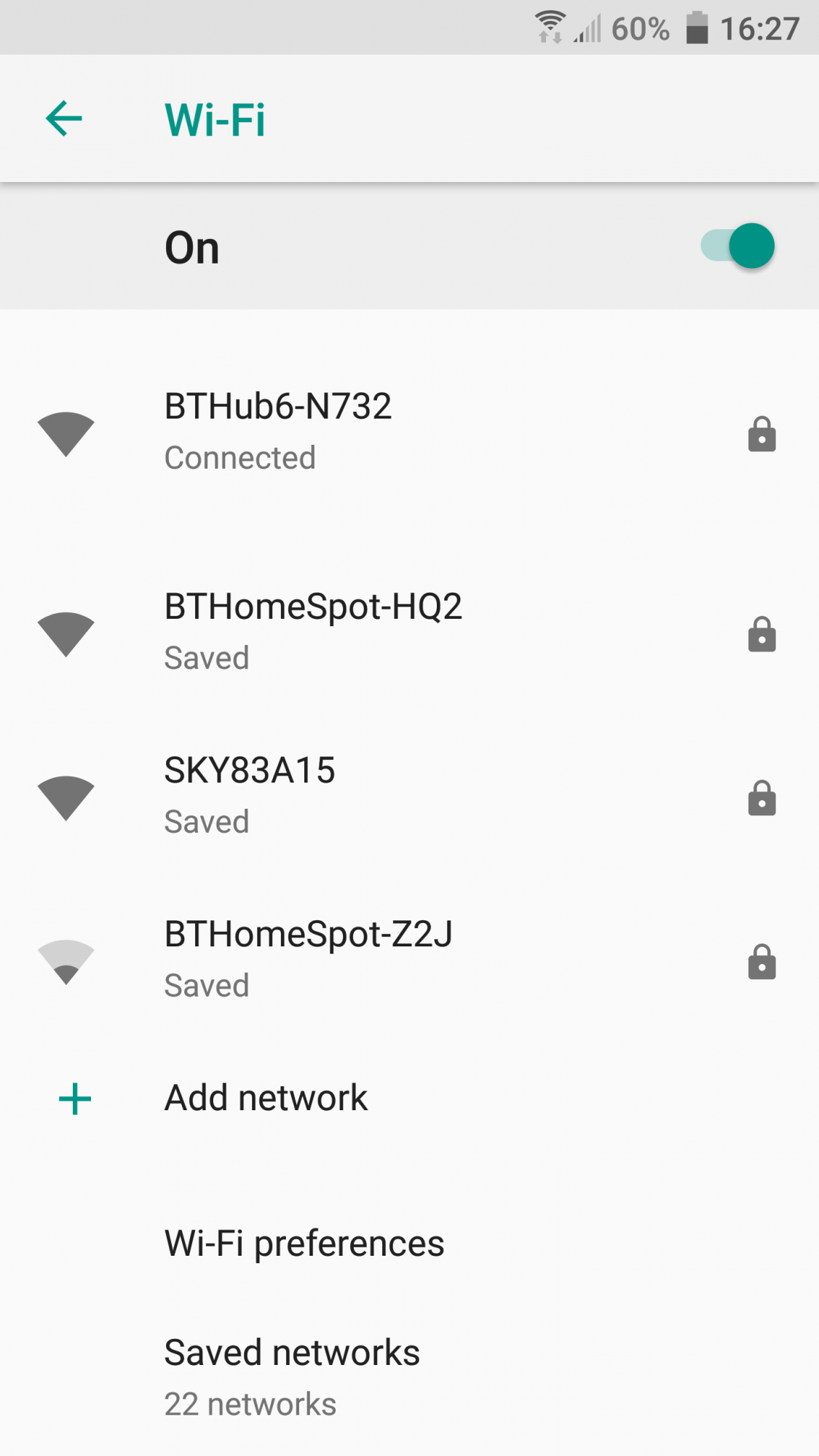

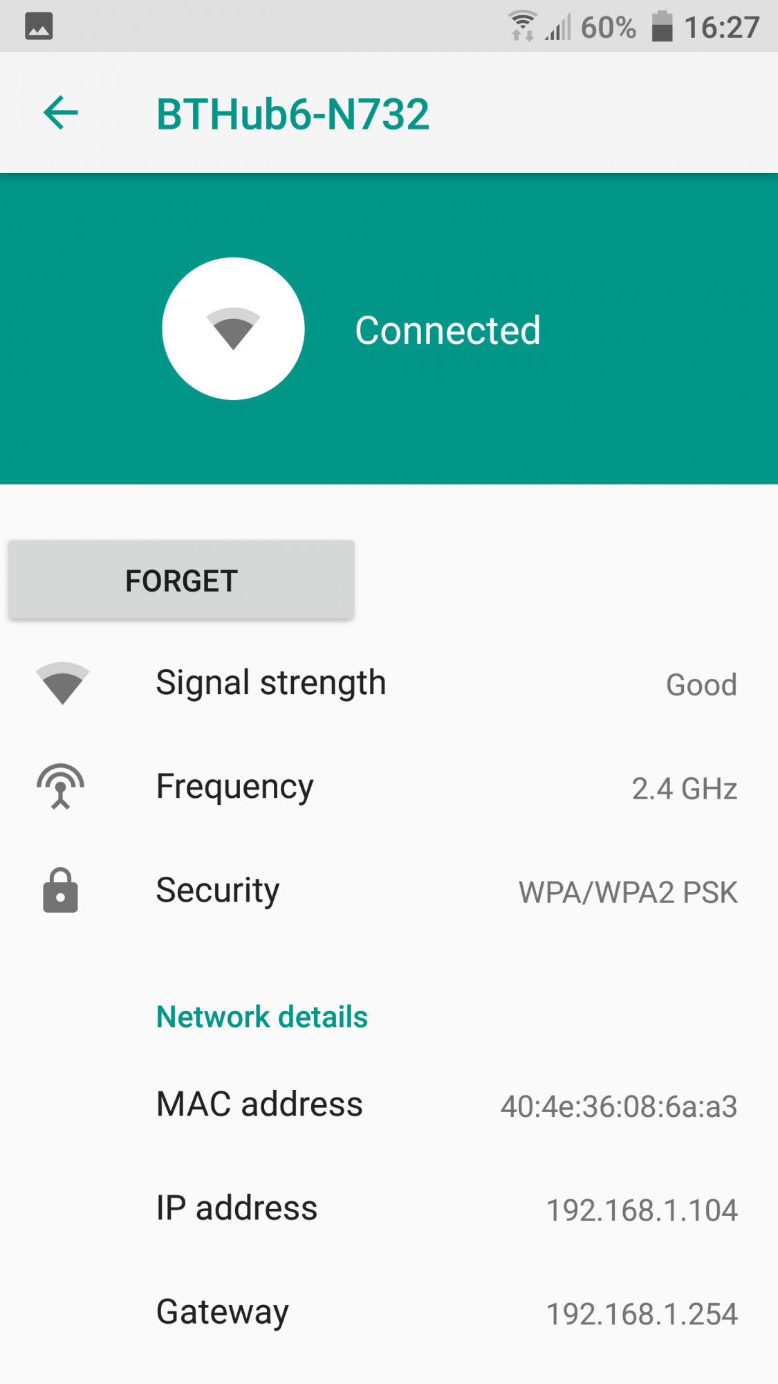

As a matter of interest could you check what band you are using when you sign in to your router/hub, it will be either 2.4Ghz or 5.0Ghz.
To check it, once you have connected go to Settings-WiFi and tap on 'Connected', you will get a screen showing the band as in my screenshots :-

It's 5 Ghz.
When you are using WiFi calling are you usually in the same place in the house and how far from the router/hub are you, or are you in the same room?
The 5.0Ghz band gives a faster connection but the signal strength is reduced by distance and particularly walls/floors between you and the router/hub to a greater extent than with the 2.4Ghz band so it can become a trade off between speed and a steady, stronger but slower connection.
