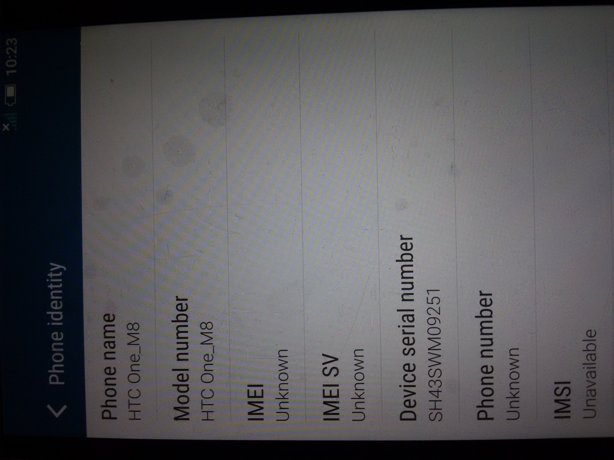

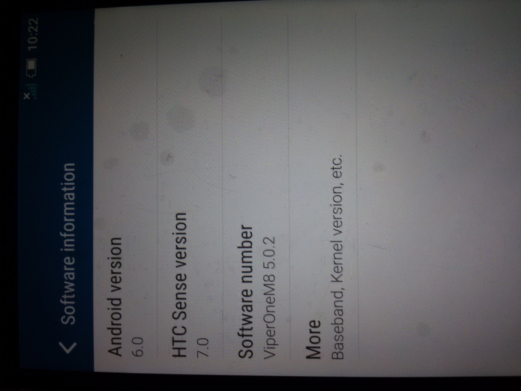

@saltire Yes sir i think ive wiped the OS. It auto updated then i did not check the battery lvl. while updating it turned off then it started in boot loop. then i thought that i had already bricked so ive tried installing roms. then ive manage to atleast fix the boot via ViperOne.
And also i have no backup cause i factory reset wipe everything system Etc. sorry for my ignorance. When i had finished the ViperOne i noticed there was no network/Wifi/Bluetooth.:( Now all i want is to restore my phone atleast stock for as long i can use it. BootLoader Unlocked. Thank you very much sir. :D

Network/Wifi/Bluetooth not working are probably all due to a mis-match between the firmware version currently on the phone, and the ViperOne ROM software base - running newer software with older firmware tends to break stuff, Wifi being most common. Unfortunately it also looks like with the version of TWRP you have - probably 2.7.0.2 - it's the version that removes the firmware version info so the version-main entry in your text output is blank, and line on the bootloader screen for OS is also probably blank as well.

Just having a look at those screenshots, and the thing that concerns me the most is the IMEI showing up as unknown. This might mean we need to run a full RUU to rectify this, but I haven't found one that matches your current radio version - and without S-OFF you won't be able to revert to older firmware. So try the following first.

Finished following your procedure @saltire . :D No Problem installing 4.19.707.4 Zip & Recovery. But it still has no IMEI :( Im going crazy. What step shall we do next? in not loosing this phone. huhuhuhuhuhu..:(
That's what I was afraid of. Having the phone auto turn off due to low battery when running the OTA update is never good, and best case scenario has left you with some firmware components updated but some that are not. Worse case scenario is failure part way through the install of one of the firmware images which probably means it's now corrupted. The fact that the IMEI is now showing as unknown is related to the radio img, however you are not s-off so we need to find a signed RUU. The problem is I can't find a signed RUU that now matches the radio version you got from the getvar all command, the only RUU I could find is here:
http://androidruu.com/getdownload.p...06G_20.69.4196.01_F_release_414204_signed.exe
You can try and run it, before you do you need to get stock recovery on and relock bootloader. It might work but I don't think it will. If it doesn't I think your best shot is to get in touch with HTC and if the phone is still in warranty see what they say if you tell them the OTA process failed.
