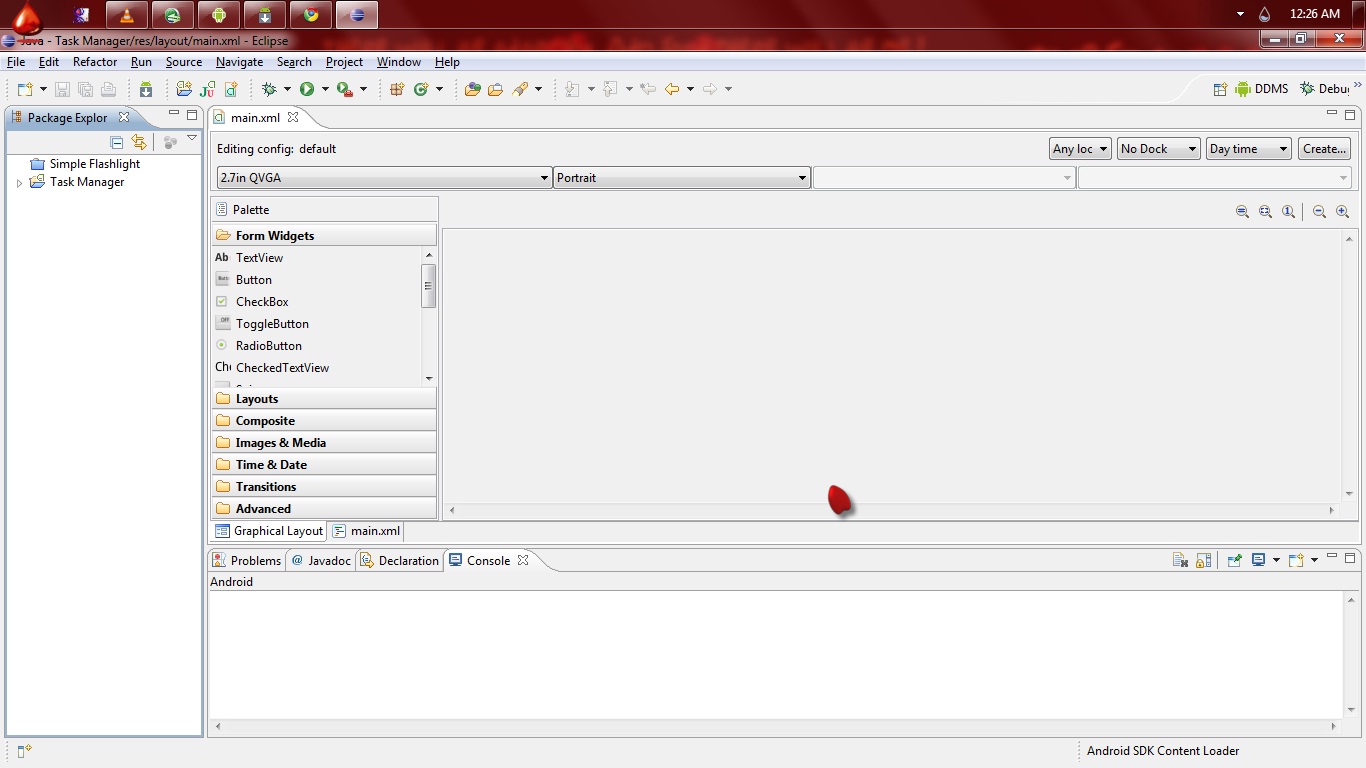

Im building an app and the target is Google APIs, platform 2.3.1 and API level 9.
When i finish creating a new Android Project this way, when i navigate to Graphical Layout in main.xml, I cant see the layout. I cant select the theme for the any skin either as it is grayed out. May i know how to solve this problem? I want to see the layout preview.

I start off with Eclipse. Create a new Android Project with build target GoogleAPIs (platform 2.3.1 & API level 9). I fill in the respective fields in the New Project form. Then when i navigate to main.xml and select the Graphical Layout tab, the preview of the Hello World string isn't shown. Nor can i see a black screen layout.

I've uploaded a screenshot to make it easier to help me.
if there's no preview try and drag something like a framelayout into the screen (under the layout tab)
if this doesnt work try to clean your project (in the menubar__ Project->clean->Your project
If you try dragging on something like normally. If the error shows as "missing theme" you need to select the android version your using. Should be one of those empty tabs up there.
