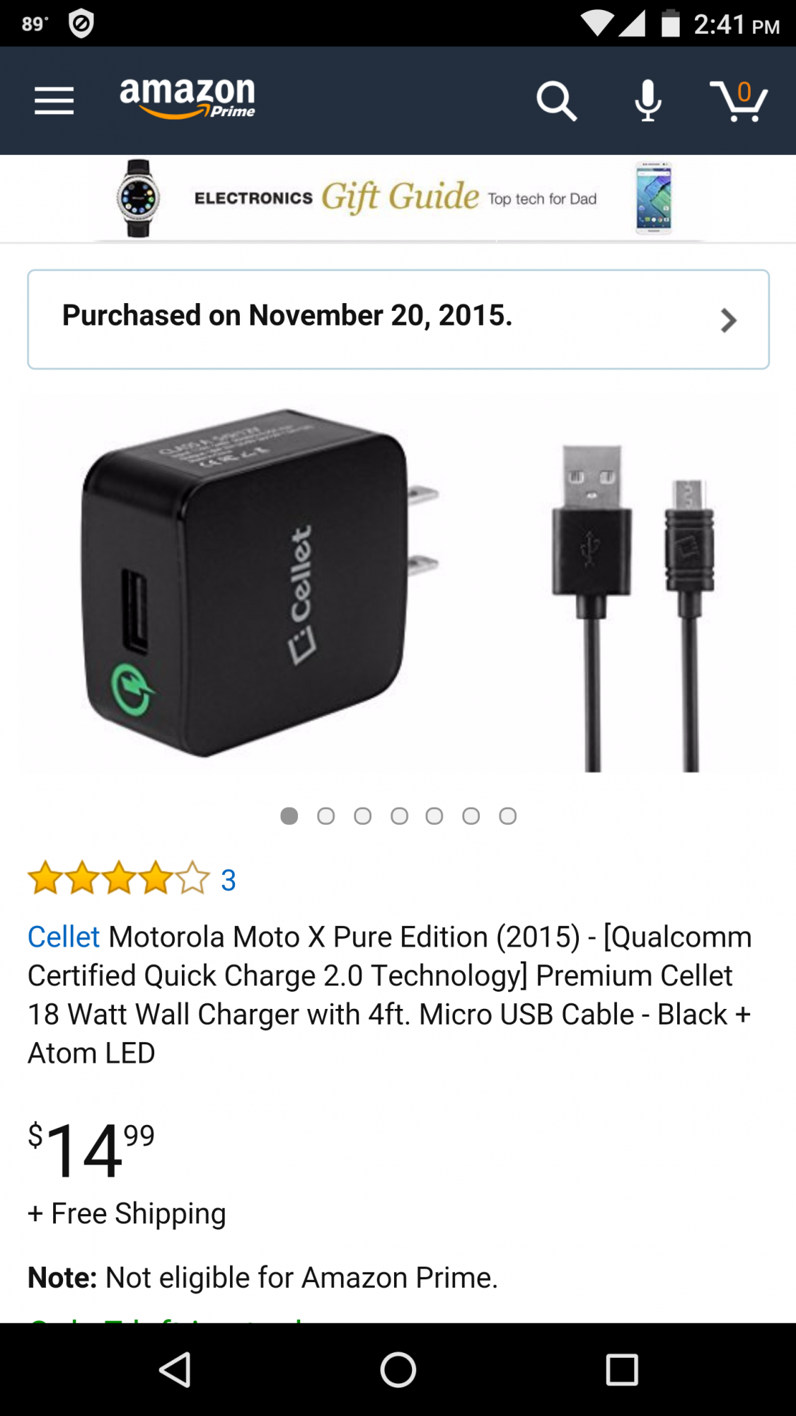

Okay, so, while I am initially disappointed with the standard charger having a non-removable cable, it at least does quick charge... or rather, did.
It seems like no matter how many times I unplug and reinsert the cable for the quick charger it came with into the phone, it simply will not quick charge at all. It still will quick charge from the external battery I have here, so I know it still can.
I picked this up as a second charger, mainly to keep at work if I double over. Still using stock factory one at home.
Clean he dirt and lint out of the plugs and sockets?
... Thom
From where, though? Seems that of the two, it's the factory charger that's refusing to enable turbo charging though.
What is strange is that with the factory charger, it then insists it's "charging over USB", while with the battery, it's "charging over AC". And now with the stock charger, it basically takes an eternity to work.
Plugs/sockets in the factory charger. If they are clean then it would appear that the cable is bad.
(I'm using the Turbo charger with the Droid Turbo 2 and don't know if it is the same one you are using.)
... Thom
Tried that; and weirdly, the factory charger does appear to quick charge the external battery just fine, too.

Try a different OEM charger and see if you get the same result?
... Thom
Not going to be able to find one around here. Or at least an OEM one. Best buy for example still happily displays it as an available choice, but refuses to sell any accessories for this phone.
Fry's electronics is where I got this one, buy also had meager to no accessories. The only battery pack they had was one of those models that explicitly was incompatible with this phone.
Update on my end. Decided to say "f*ck it" and look for a replacement charger. Best Buy wanted far too much for either a home or car charger. Swinging over to Fry's Electronics, where i first purchased the phone, and I found I was able to pick up a separate home and car charger for the price that Best Buy wanted for *either* qualified quick charger to use with the phone. At least the home one even provides an extra USB charging port while it's at it.
