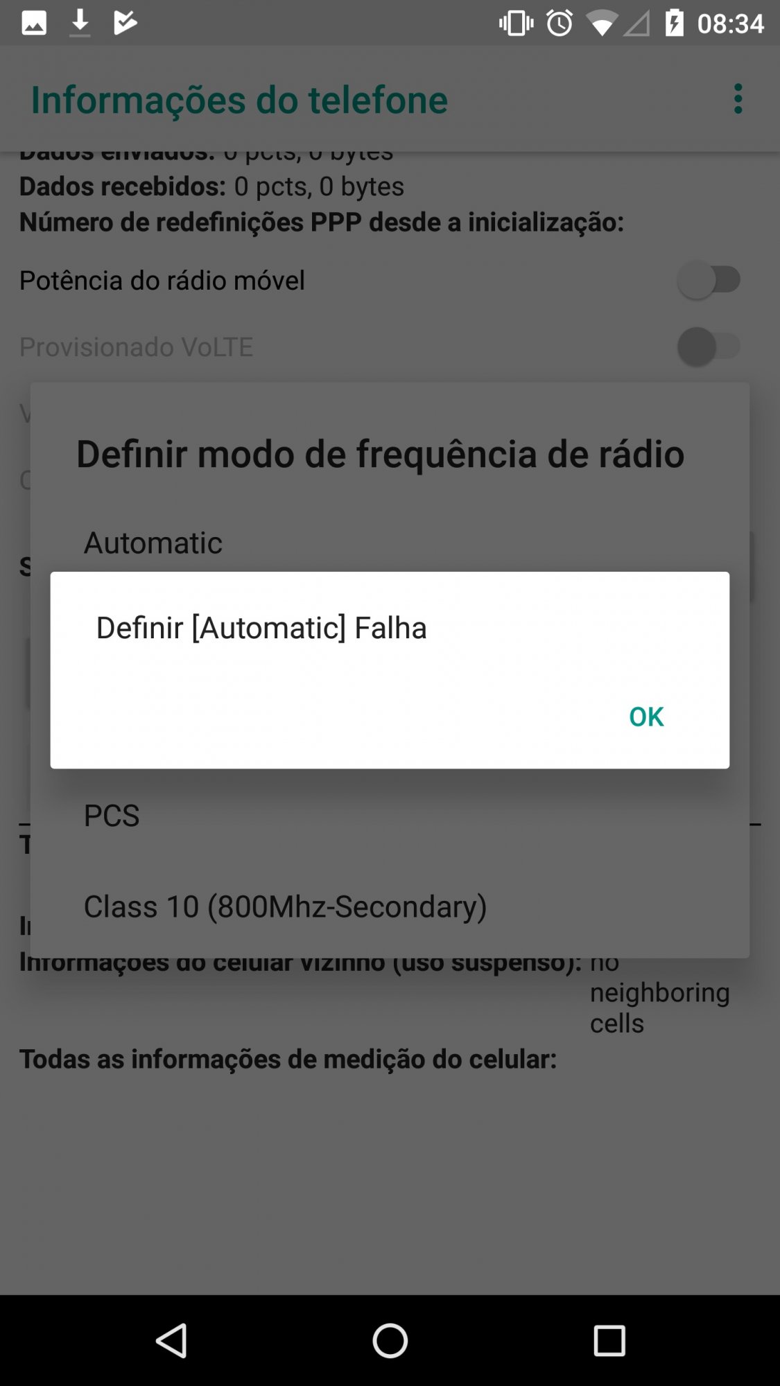

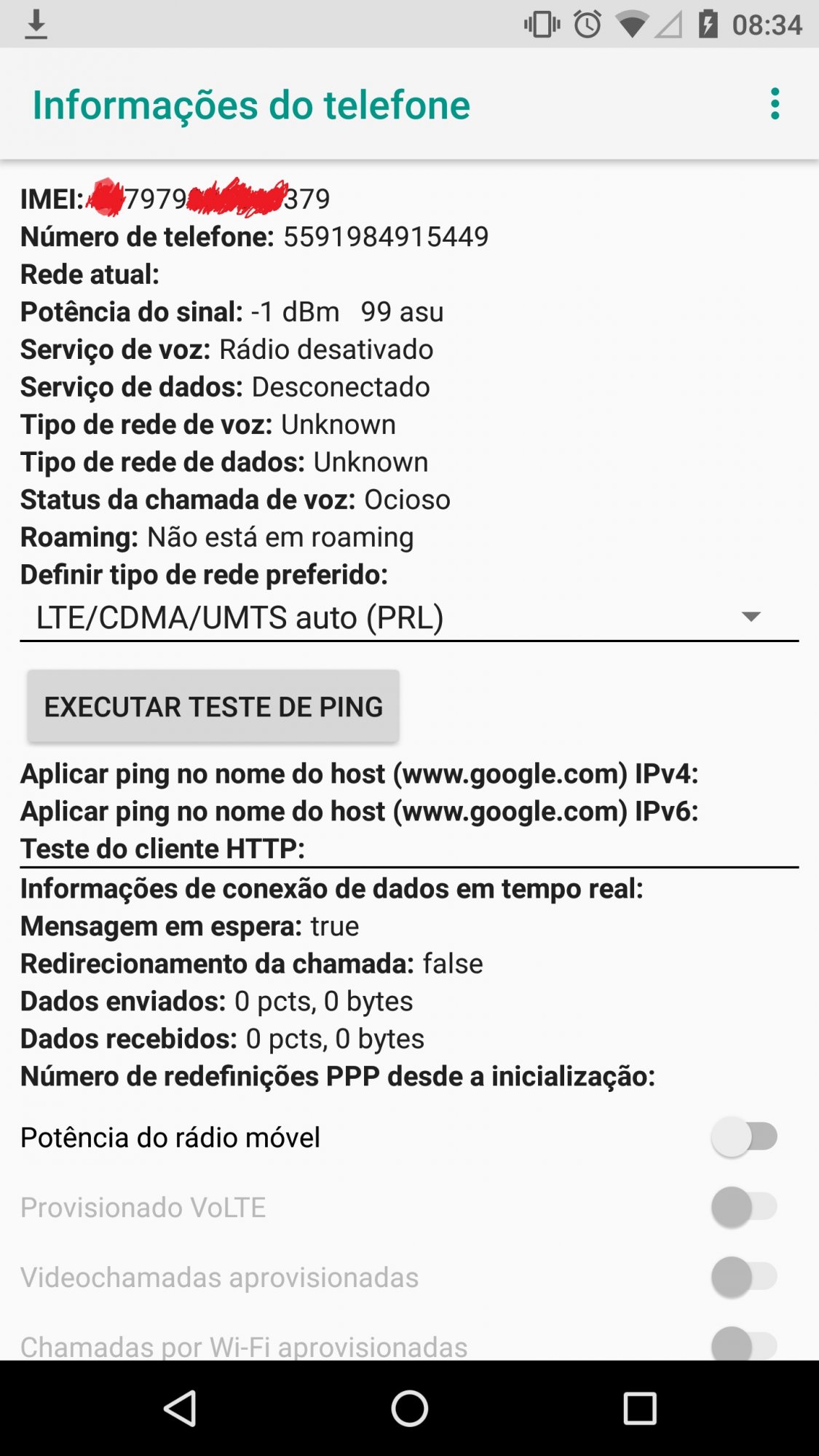

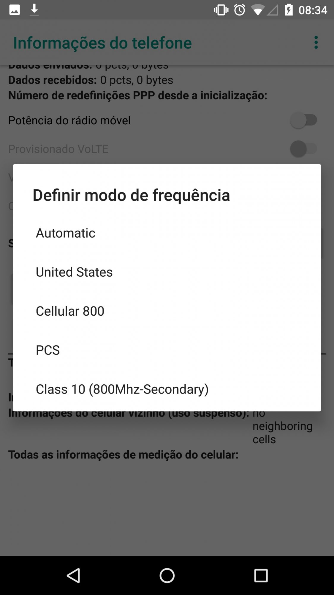

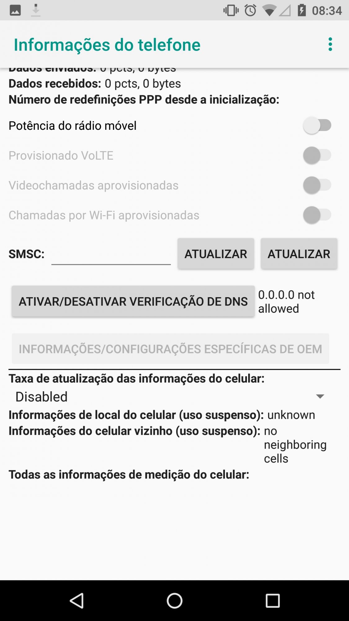

Hello everyone. get a Nexus 6p recitemente from a friend and the same has the following problem: it does not show the network signal there is only a warning in the upper corner of the screen saying "no service". I already used the codes * # * # 46 ... but every time I try to change the band it says "failed". so I installed Chroma Rom to test and get the same results from the previous tests, I also can not turn on the radio, and I click the power button but it does not turn on. I also installed a different radio band and it did not work. every time I try to make a call it returns with a warning that I have to turn off airplane mode, but airplane mode is not even connected in this case. I'm in Brazil and I've tried several chips all without success. Sorry, I'm using the translator. some screenshots below

I think it comes to that too, every time I try to change the radio band I get a "failure" warning like this one in the image. I've tried all the brazilian operators: Hi, Tim, Claro. Live

as I said, I entered the forum xda to get more information regarding the error, I already tested several methods sujeridos la, including putting a tape on the tray of sim so that the same sim car of the board connectors, but also did not solve . they said there that the chroma rom would solve, because it has more bands, but in her also when I select the different band always retona the error "fault".
A ROM cannot give a phone more radio bands. I could imagine that if it's based on a different version's software its service menu might offer more options, but unless the phone's hardware and radio firmware were compatible with that then nothing good would come from trying to use them (the radio firmware has to be compatible with the ROM, but is not part of a custom ROM). Anyway, in terms of frequency bands a completely stock 6P should be compatible with Brazilian networks, so in principle none of that should be necessary.

the sim cards I used work very well on other devices.
the modem of my nexus 6p is H1511
