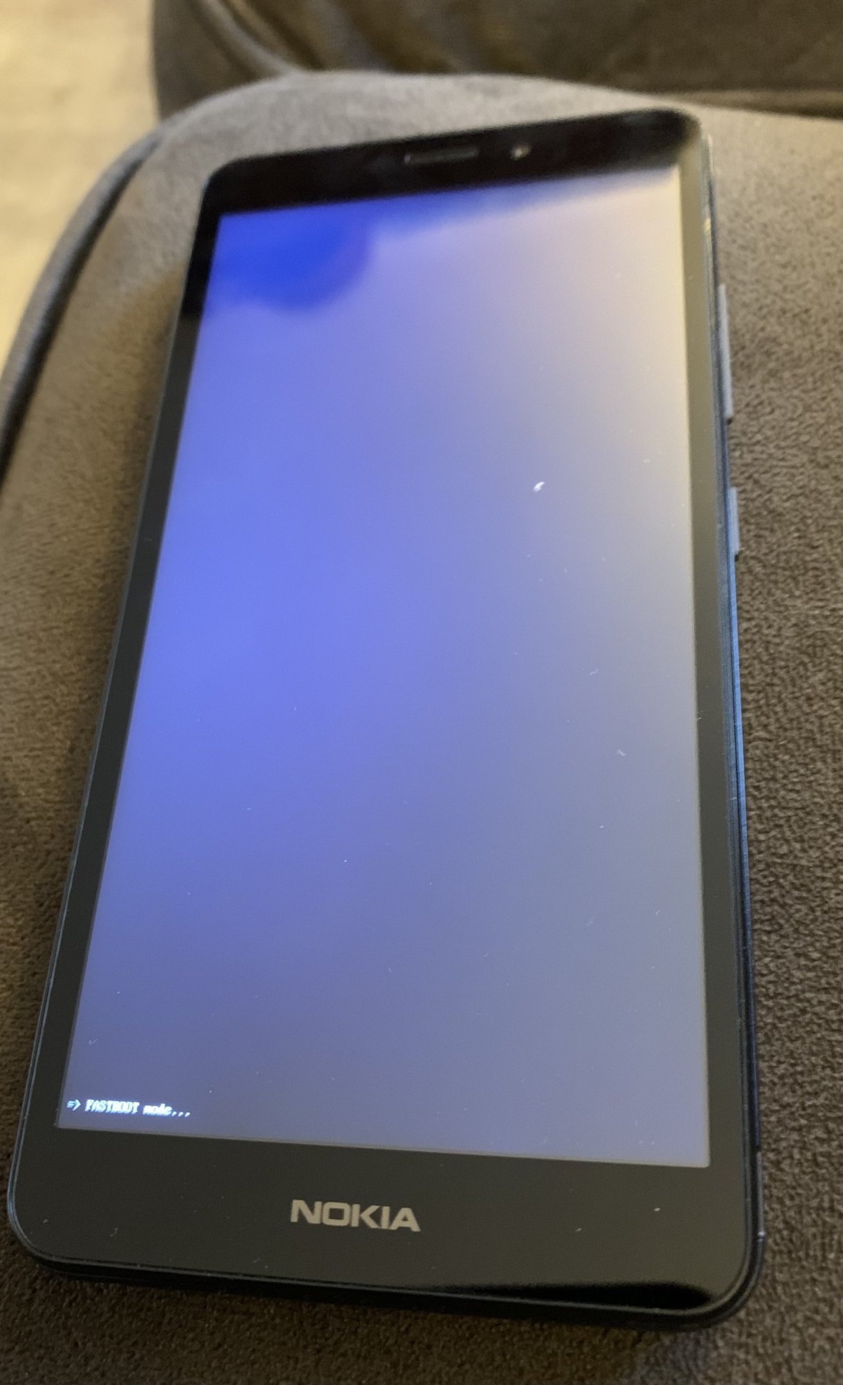

I have a Nokia c100 that has a pattern lock. I need to be able to get in to the phone or hard reset. data preservation not necessary. I tried using the boot loader (holding down power/volume up or/and down, all combinations), nothing. All I got was a small white “fast boot mode” on bottom left of screen. Is this phone trash unless you know the code? I’ve seen a few videos saying it’s impossible, but wanted to see what other people think.

you need to select recovery mode, once your are in fastboot mode. in recovery mode you can then select factory data reset.

So after I hold down the power button and volume down I get this
