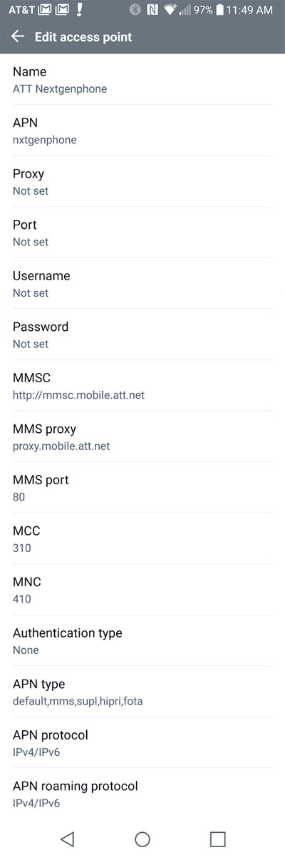

Tweak your APN settings. I have had to add a new APN with the same settings as the default settings but I have had to change one thing:
APN Protocol -> ipv4/ipv6
EDIT: Missed your 2nd post. If your phone is unlocked, you need to double check the APN Settings. Also try Textra if you cannot miss text messages.
These are the settings that have been working for me.
