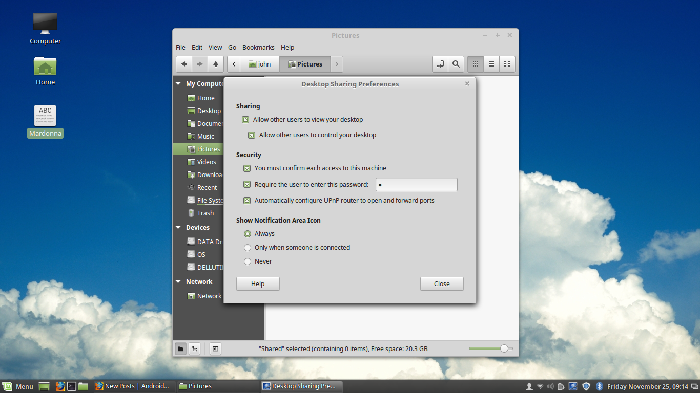

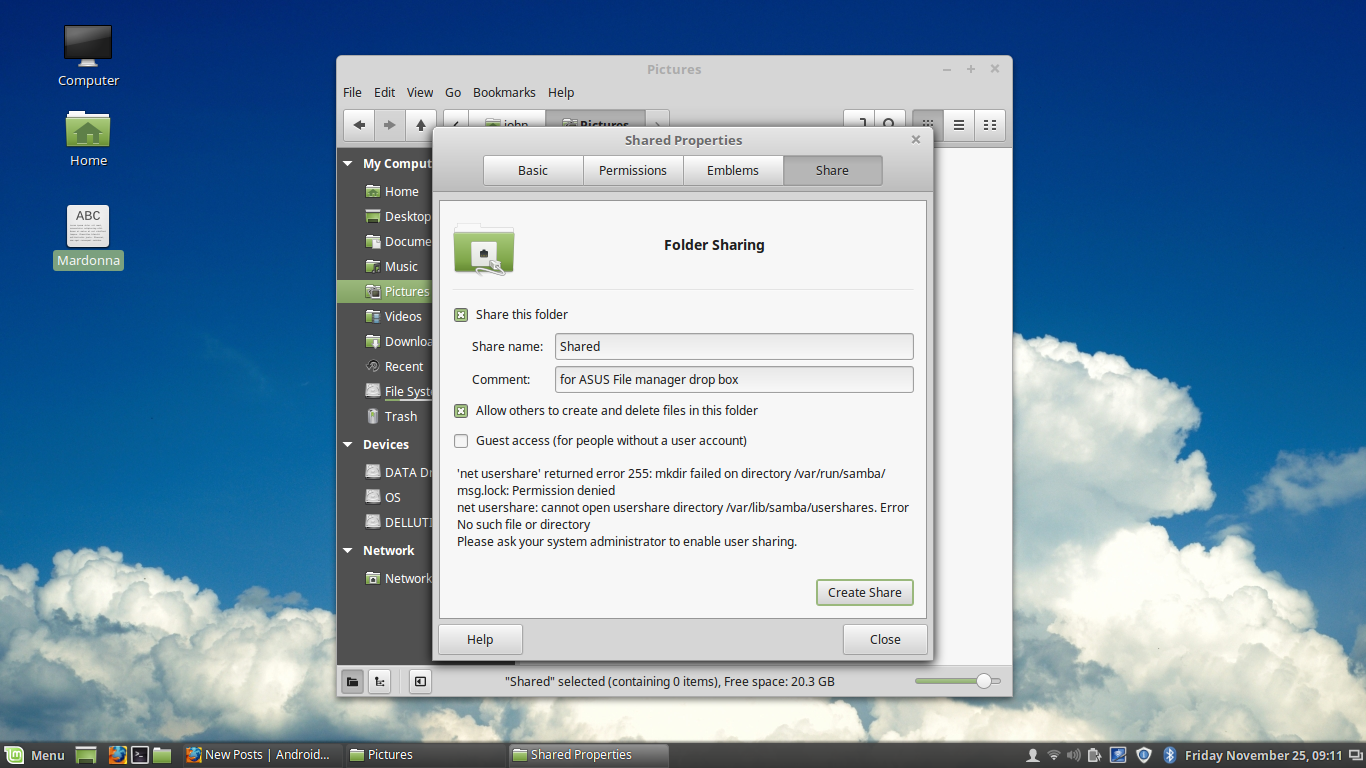

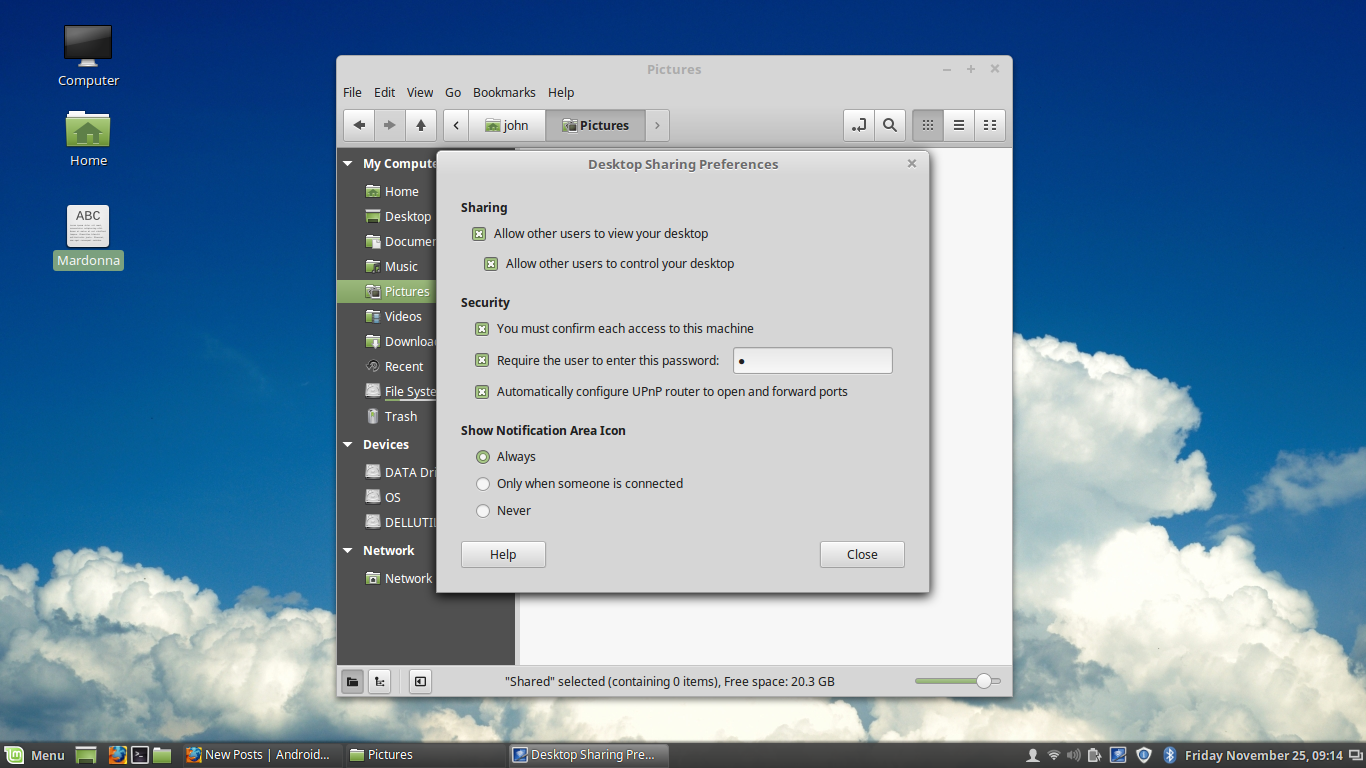

I tried to upload a couple of pix to finish the joke out, but Linux is bitching at me on this laptop. This is a brand new install of Linux Mint 18... on my other laptop, which has Linux Mint 17.3 sharing on it enabled w/o a glitch. I don't know what to do, I have tried the Admin permissions as shown below. Anyone here good in Linux? I am a MicroSloth escapee...
What I need to do is Share a folder so that my ASUS Filer Manager can access it via WiFi.

Well,
Yes, I am a Linux system administrator so I can try to give you a hand.
The screen shots you have posted relate to the sharing of your desktop, and therefore will only be useful if you want to remote control your laptop from your Note 4 or another computer (I use this quite frequently, but I guess this is not what you want). You will need to set up one or more Samba shares. Samba (or SMB or CIFS) is the file sharing protocol of Windows and is supported by Linux.
Now, I don't know Linux Mint (because I am a command line type of guy), but I would assume that you will need to install the samba package. Then you should be able to share one of your folders (it could be that your home folder is shared automatically). So, look in the package/application manager for something mentioning samba or SMB and install it (Note: you'll need the server not a client). Then try to connect again, you may get lucky with the default settings.
If you cannot find the package or don't get lucky, let me know how far you get and I'll try to help more.

:D:D:D:D:D:D:D:D:D
What a Life Saver you are.
I found a package called GUI SAMBA and installed that, and Wallah! the next time I used that Share Option in the file manager, Bingo! it did what I wanted it to do.
@touringhaggis Thank You, thank you, so much...
