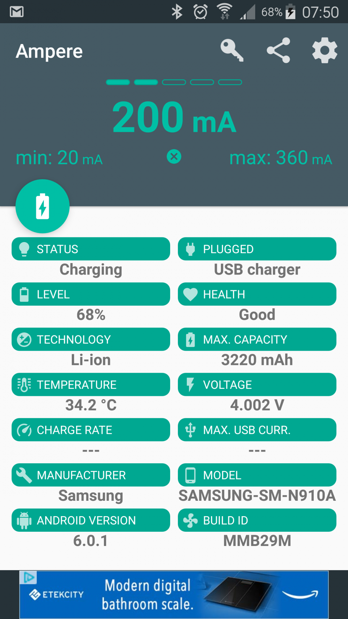

Ok so i changed the usb port out hoping that would fix the problem of charging and connecting to the computer but changing the usb out is not working. Also i downloaded a app called ampere, this app measure how much power is being used to charge your phone and on my n910A the battery charge is between 40 mA to 380 mA with it normally sitting around 120 mA with my N910H with the same apps installed and it measures between 400 mA to 1020 mA with a normal around 630 mA so there is something wrong with this phone idk what it is..
My N910H is charging way faster then my N910A is it has a good usb port the only thing it i think it is... well the mother board but idk

If you look at the screenshot I was changing the same battery with two different phones it is not the battery... Something with the phone is wrong not the battery or cables.. or USB port... Or power brick
