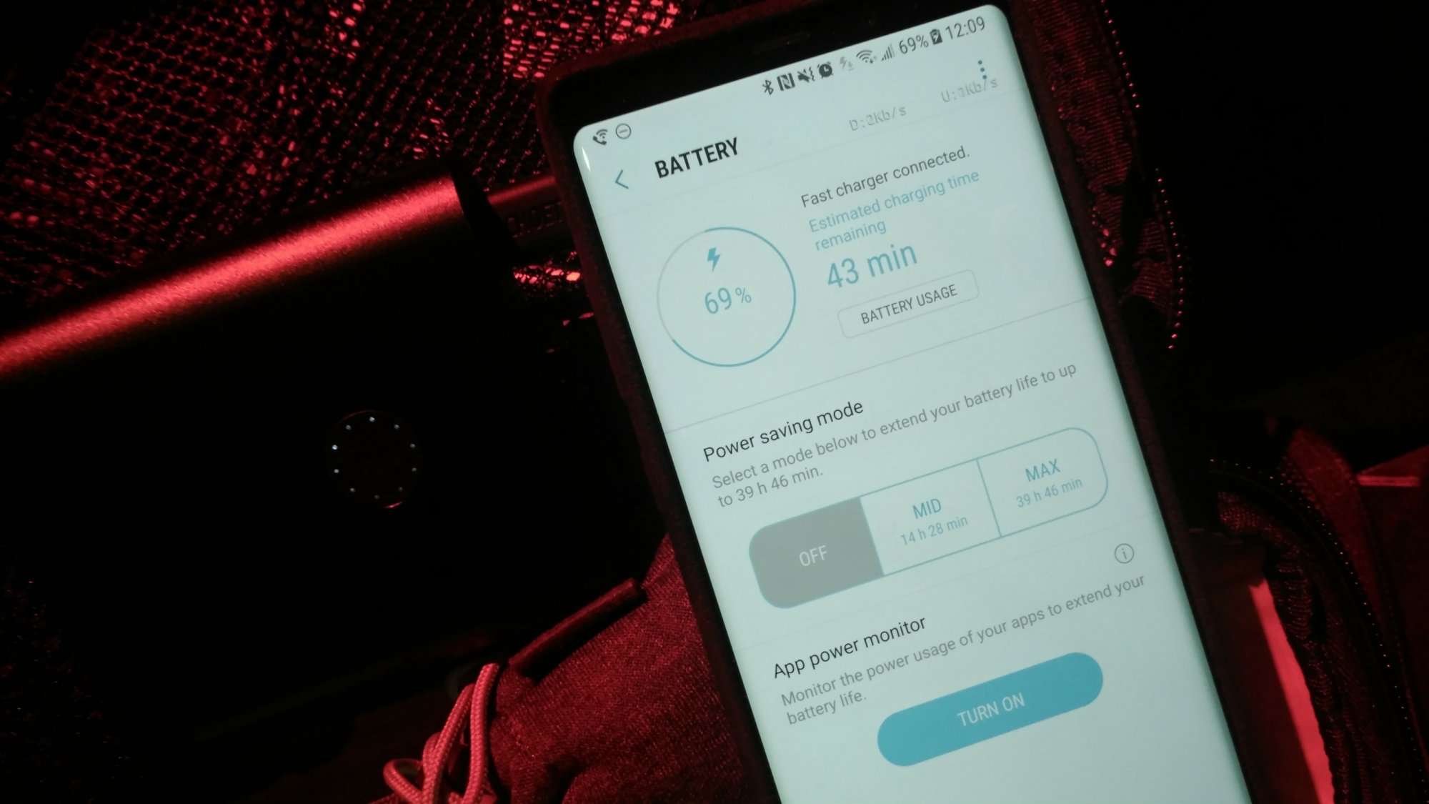

With the USB 3.1 gen 2 super speed cable from choetech, im also getting PD speeds from the powerbank. The phone shows its fast charging (see photo).

I have had this powerbank (July) even before i got the note 8. As it shows the note8 recognizes it as a fast charger.

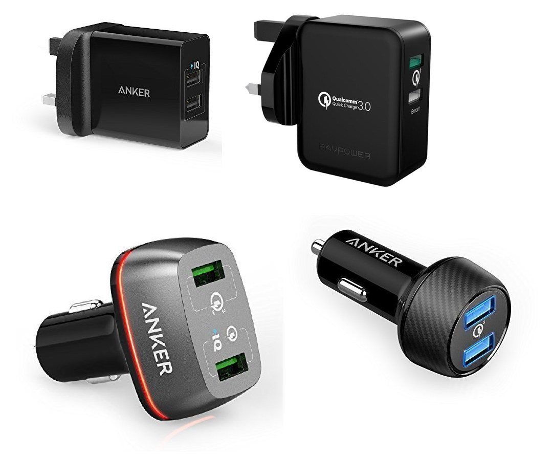

I am discovering the hard way that there are different fast charging protocols out there. The Note 8 uses a different protocol than others may do. A fast charger that works for one device [eg the s6?] won't work with the Note 8 etc. Ditto car chargers.
Any pointers appreciated. (I think the Note 8 uses Qualcom 2.0?)
LOL! I modified the commandment to be more relevant. They never put the plugs near the seating.
Well I always carry a 5m charger cable so proximity isn't generally a problem.
But seriously guys. I ended up with a fast charger that won't. (Vendor is sending me a freebie that will - on account of my product review.)
Somebody must have written this up. Wiki didn't help.

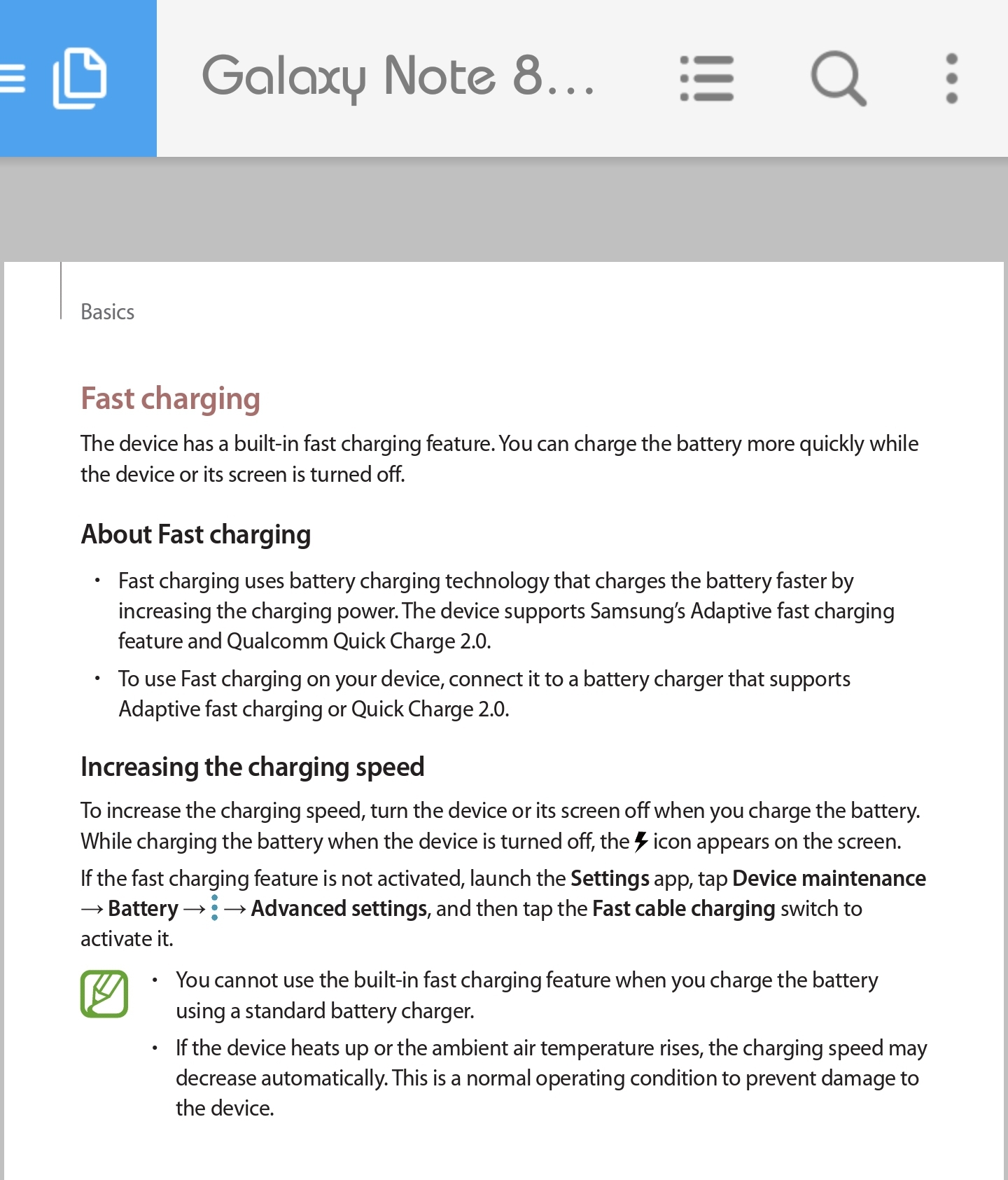

Its 2.0 for heat reasons. Samsung played it conservative this time around.
The note 8 can take advantage of PD charging speeds also...
Updated thread subject to be more helpful in searches.
The note 8 uses qc 2.0 and you can use PD enabled chargin devices to get a boost in speed.
Earlier in this thread I show using an Anker PD enabled power bank. The note 8 sees this as a fast charger and charges at faster speeds.
Stick with qc 2.0 (no need to go higher —note 8 wont take advantage of the faster 3.0 spec. Will just slow rot 2.0 speed) and you will be golden.
I think I got a Power IQ. Didn't work. My Qualcomm standard one (Ravpower) does. Not sure which car chargers do or do not.
If they are 2.0 Qualcomm they will work. Even if they are not technically those chargers will charge the device.
Ive some power iq variants and they do charge the note 8, just not recognized as fast charging.

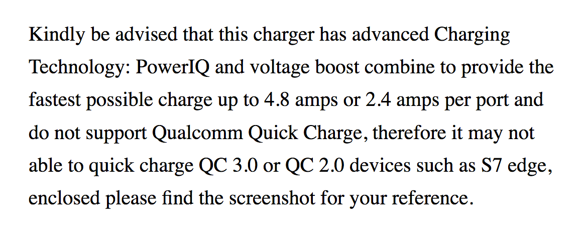

Manufacturer in an email said it didn't charge QC 3 or QC 2 devices (such as s7 edge). See screenshot. I'd done my tests with Ampere app and not relying on the phone OS to tell me.
In sum, there appear to be two fast charge systems. One is Qualcomm [2.0/3.0] which is what the Note needs (and it turns out, my wife's Motorola). The other is something called PowerIQ. It seems to be unique to Anker. No idea what that works with.
