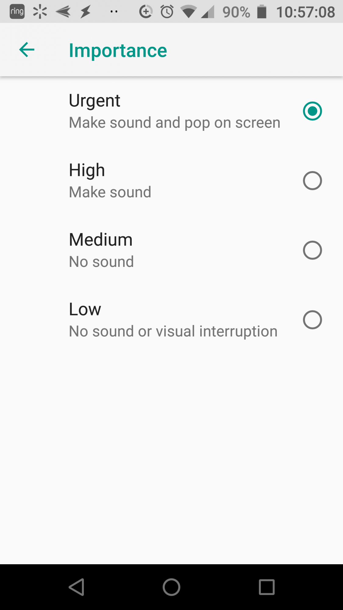

The same action can happen as part of an alert--if that's how you've set it. I'd start by going into System Settings and finding the apps you've noticed this happening with, and look at their notification settings. Make sure 'urgent' [or anything that pops up] is not selected:

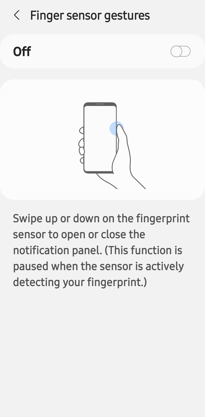

There's a setting that if turned on will pull the notification screen down when the fingerprint sensor is swiped. Turn it off in Finger Sensor Gestures
