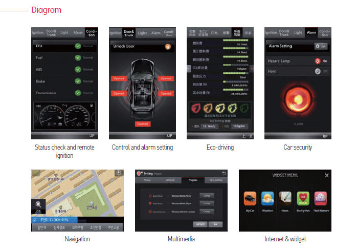

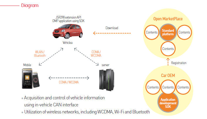

Its call this MIV mobile in vehicle in Korea...very like men in black stuff
System already been use and implemented on many app in Korea with LG, SamSung phone.
Core tech from company call CM Network cmnetwork
