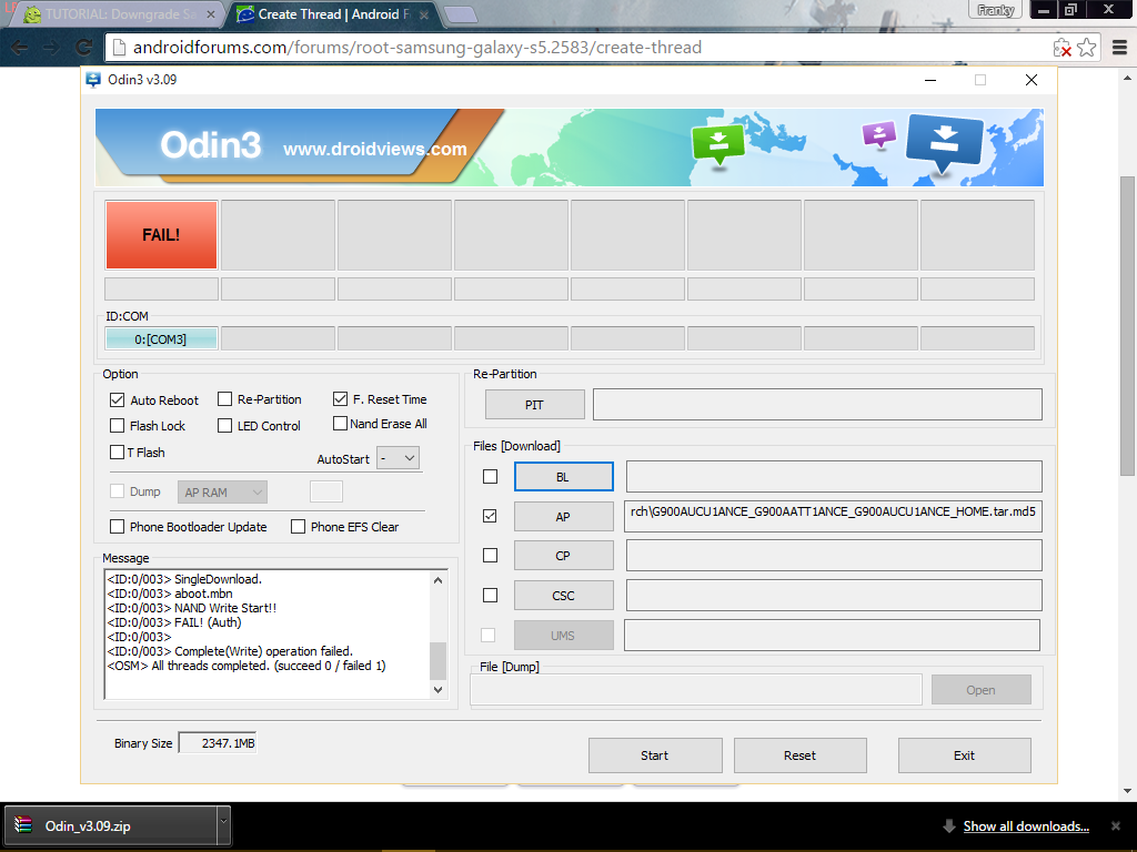

Root ODIN FAILS
<ID:0/003> Added!!
<OSM> Enter CS for MD5..
<OSM> Check MD5.. Do not unplug the cable..
<OSM> Please wait..
<OSM> G900AUCU1ANCE_G900AATT1ANCE_G900AUCU1ANCE_HOME.tar.md5 is valid.
<OSM> Checking MD5 finished Sucessfully..
<OSM> Leave CS..
<ID:0/003> Odin v.3 engine (ID:3)..
<ID:0/003> File analysis..
<ID:0/003> SetupConnection..
<ID:0/003> Initialzation..
<ID:0/003> Get PIT for mapping..
<ID:0/003> Firmware update start..
<ID:0/003> SingleDownload.
<ID:0/003> aboot.mbn
<ID:0/003> NAND Write Start!!
<ID:0/003> FAIL! (Auth)
<ID:0/003>
<ID:0/003> Complete(Write) operation failed.
<OSM> All threads completed. (succeed 0 / failed 1)
im using odin 3.9 and i tried 3.10 it fails both time.. im attempting to flash the stock kit kat firmware. i have the correct usb drives installed. the phone is sm-g900a.

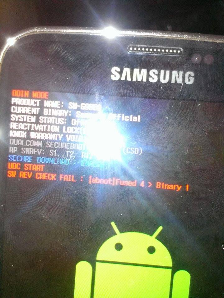

and i tried again and odin screen ob phone says sw check failed,. what gives? take a look at pic
i think you are wrong. if we can't downgrade, then why samsung host the stock firmware? im not trying to root,. im just want to go back to stock kitkat from ota lollipop
