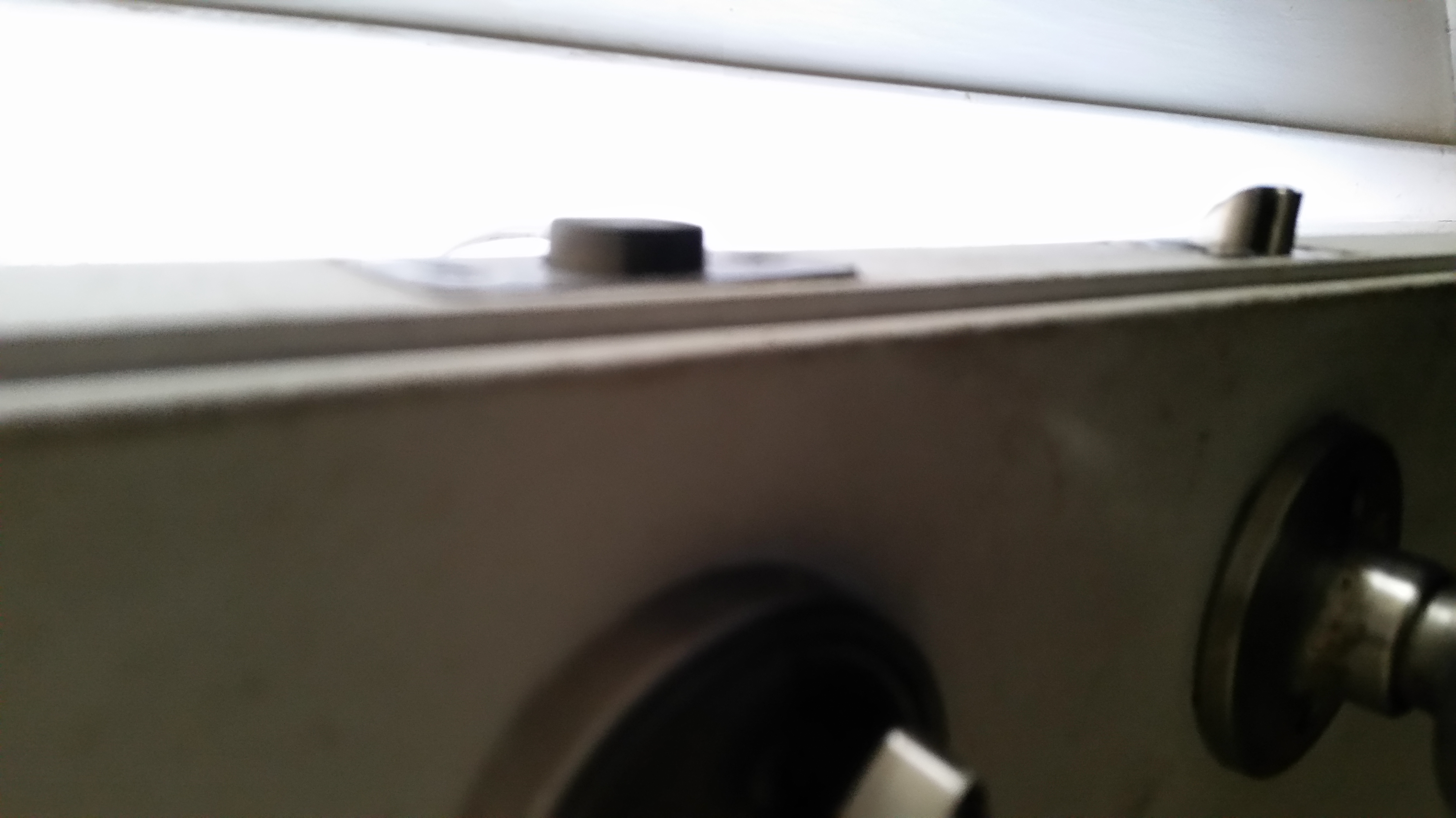

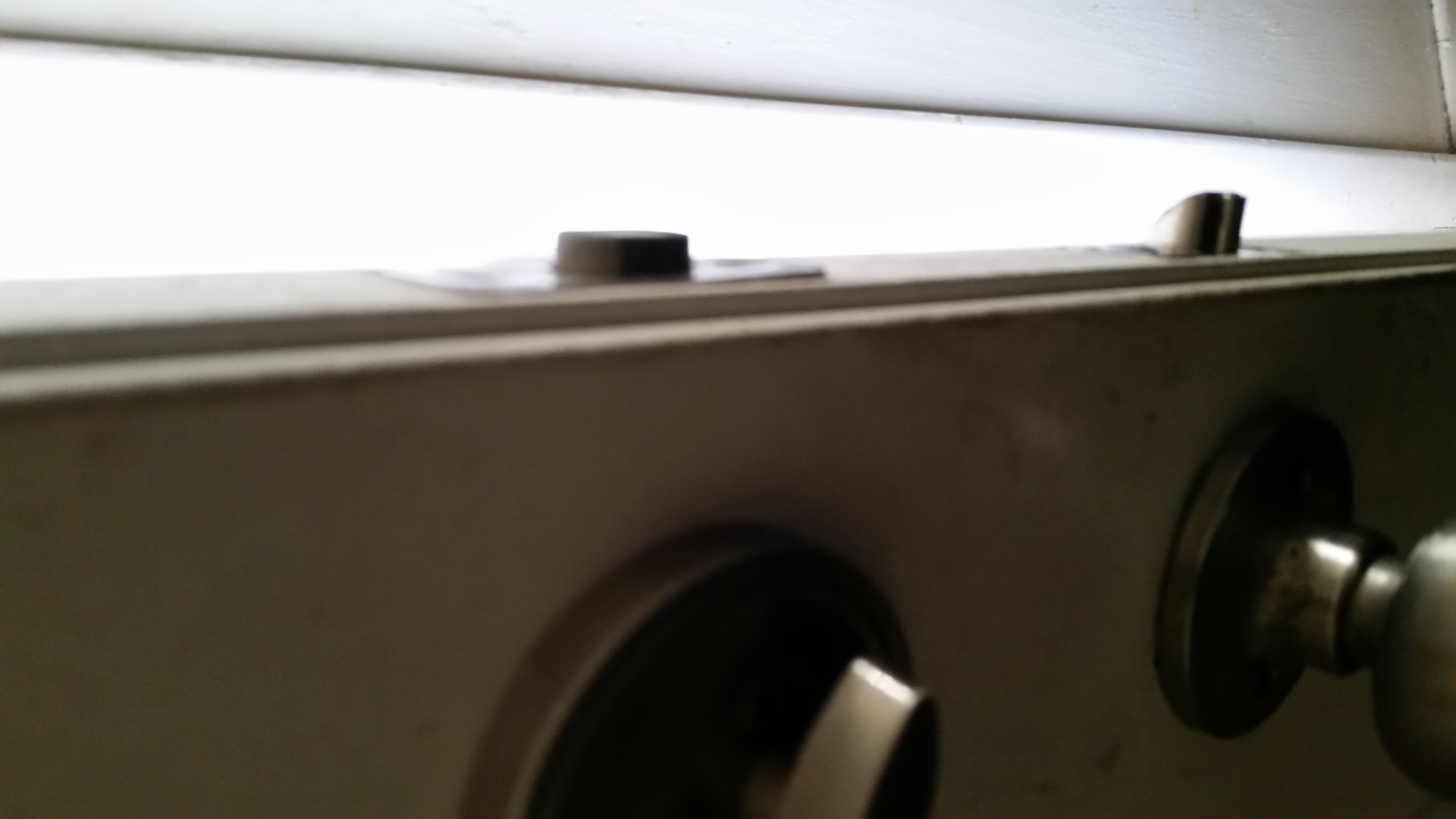

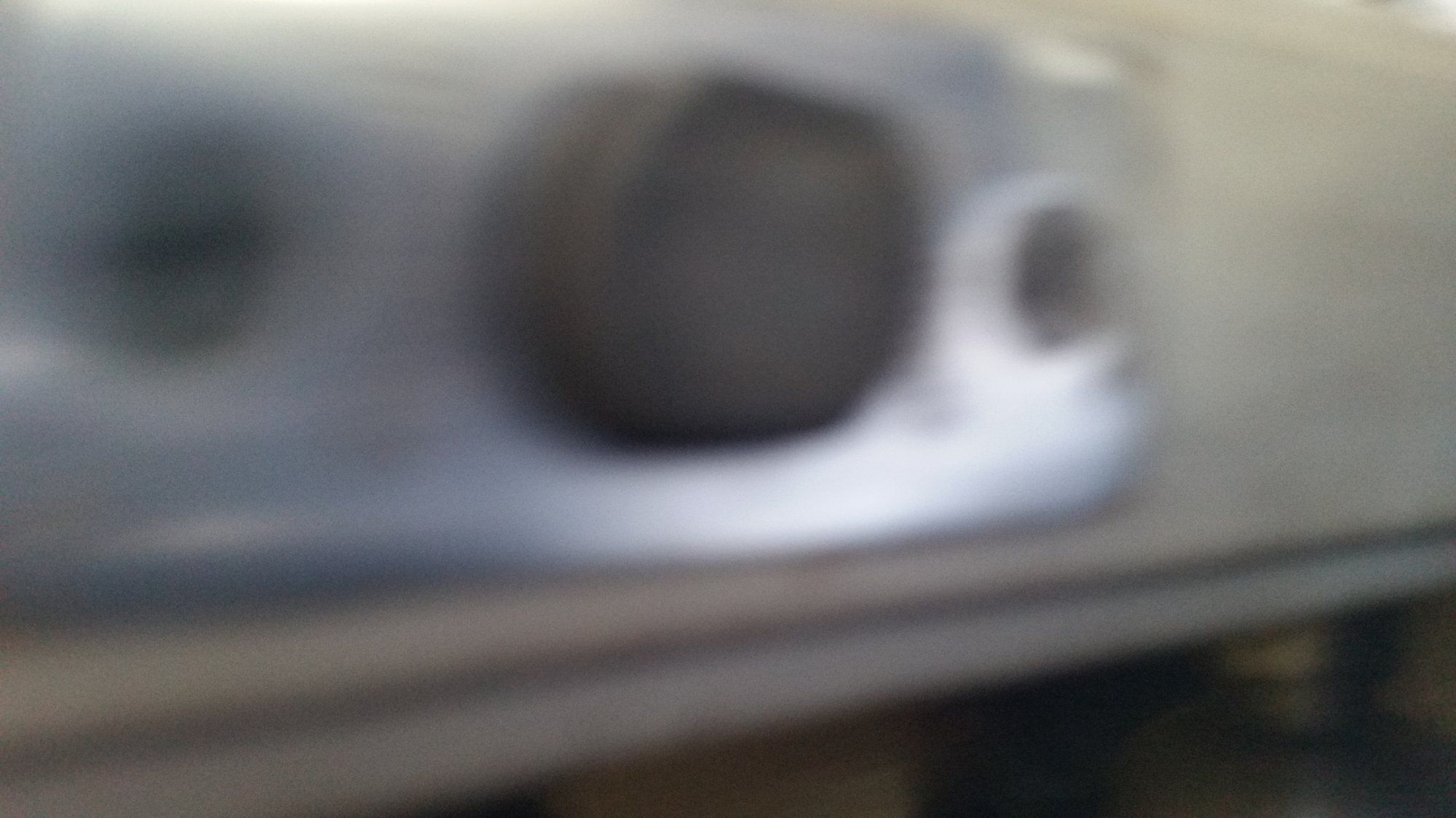

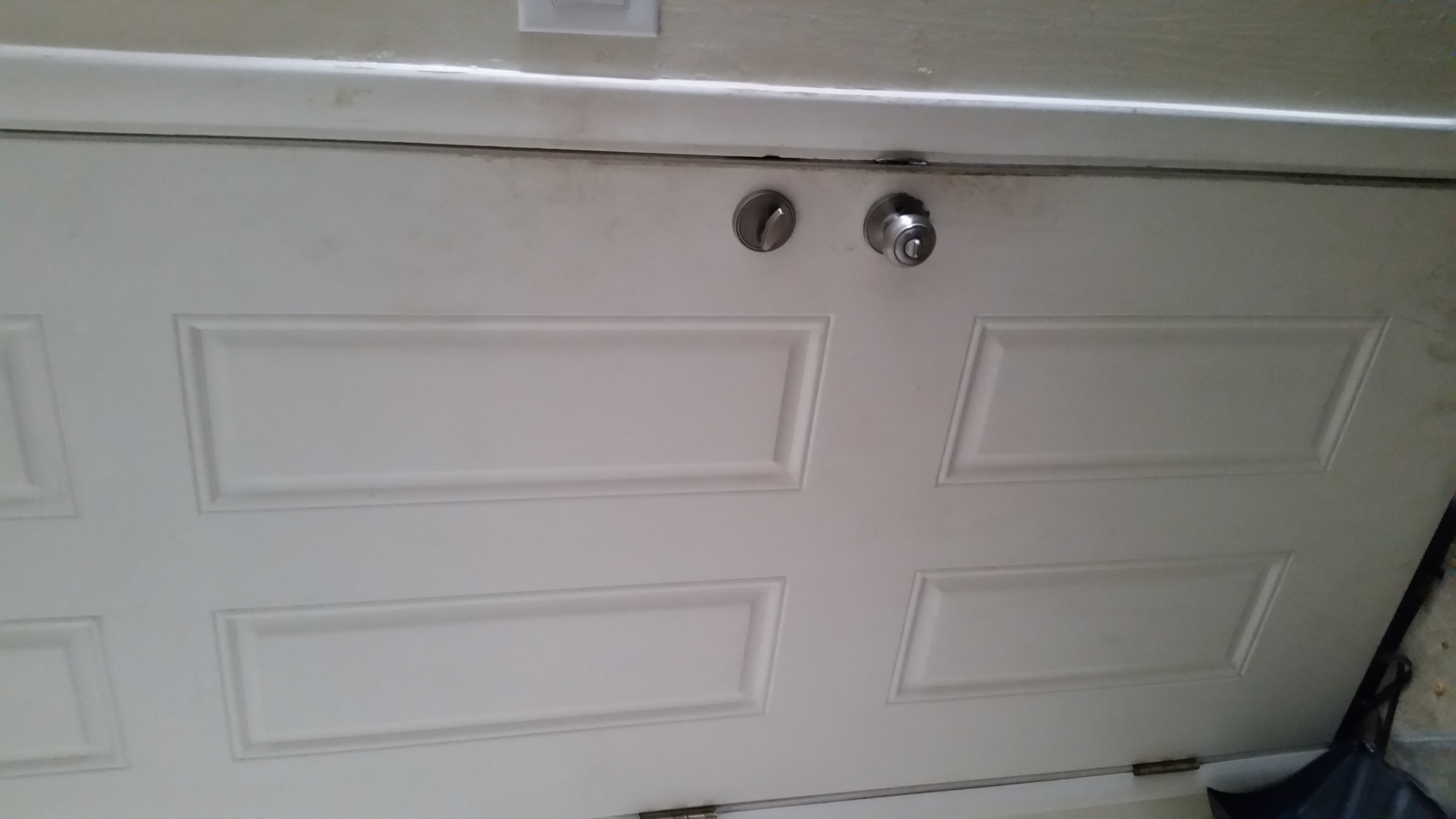

I have a couple of problems with the door. One is the deadbolt. It doesn't latch properly, at least sometimes. Also, it really needs weatherstripping. Does anybody on here know how to do that, how much it would cost, etc.? It's a metal magnetic door with a Kwikset deadbolt. Here are some pictures.

I can't see what might be the problem with your dead bolt. Being a quickset, most any hardware store will have a replacement value that they can key to match your existing lock. If the problem is not the lock itself, a slight adjust of the door will likely let the bolt easily enter the receiving keeper. Paper shims at the top or bottom hinge to raise or lower the bolt will often work. Simply unscrew the hinge and place thin cardboard between hinge at door or hinge at jamb and screw the hinge back on.

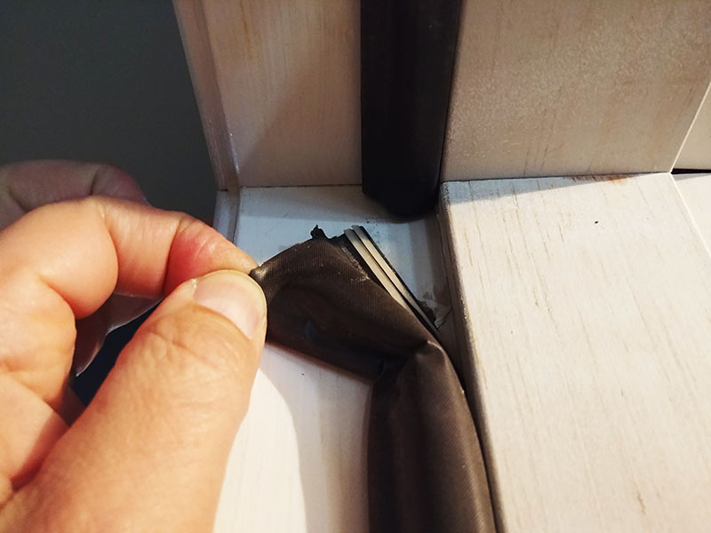

Depending on your door unit manufacturer, the magnetic weather stripping is either stuck to the jamb stop by an adhesive strip or it has a flange that fits into a receiving groove. Determine which weatherstrip you have and simply purchase a replacement of like make and replace the old.

The groove will be behind the existing weatherstrip. You will need to pull a bit of the existing weatherstrip to see if it's there or is simply stuck on.

We have a metal door at the garage (fire code requirement) and there is a channel cut into the jamb where the weatherstrip fits.
If you pull it back from the corner, you'll see the little gasket that holds it in. These things do get compressed sometimes and have to be replaced for a tight seal. Any home store should have them in stock. They are pretty standard.
