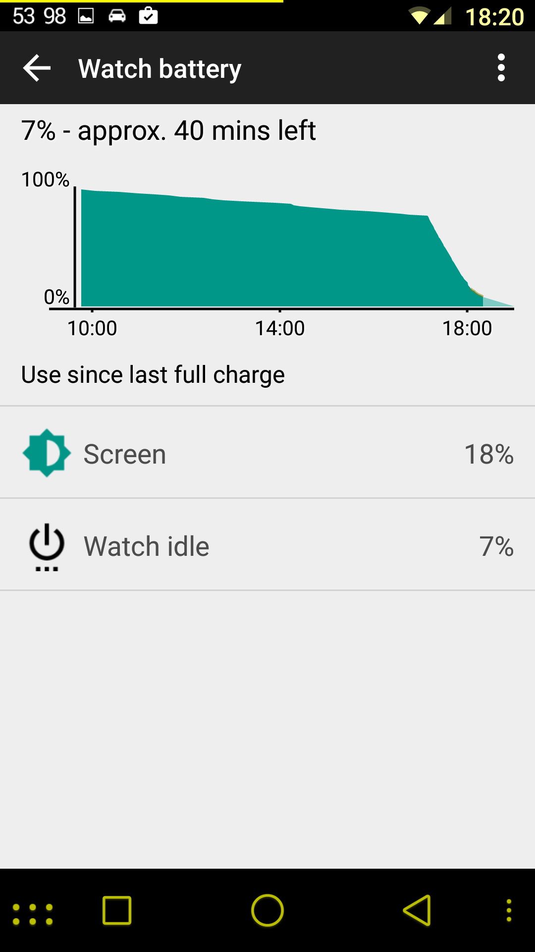

Once every month or two something odd happens that I just can't explain. Today was one of those days.
Went from 100% down to about 80% from 9AM to 5pm. So far so good.
Went from 80% to below 10% from 5pm to 6pm. WTFO.
