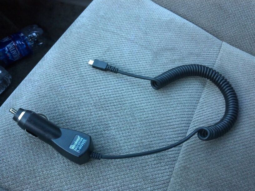

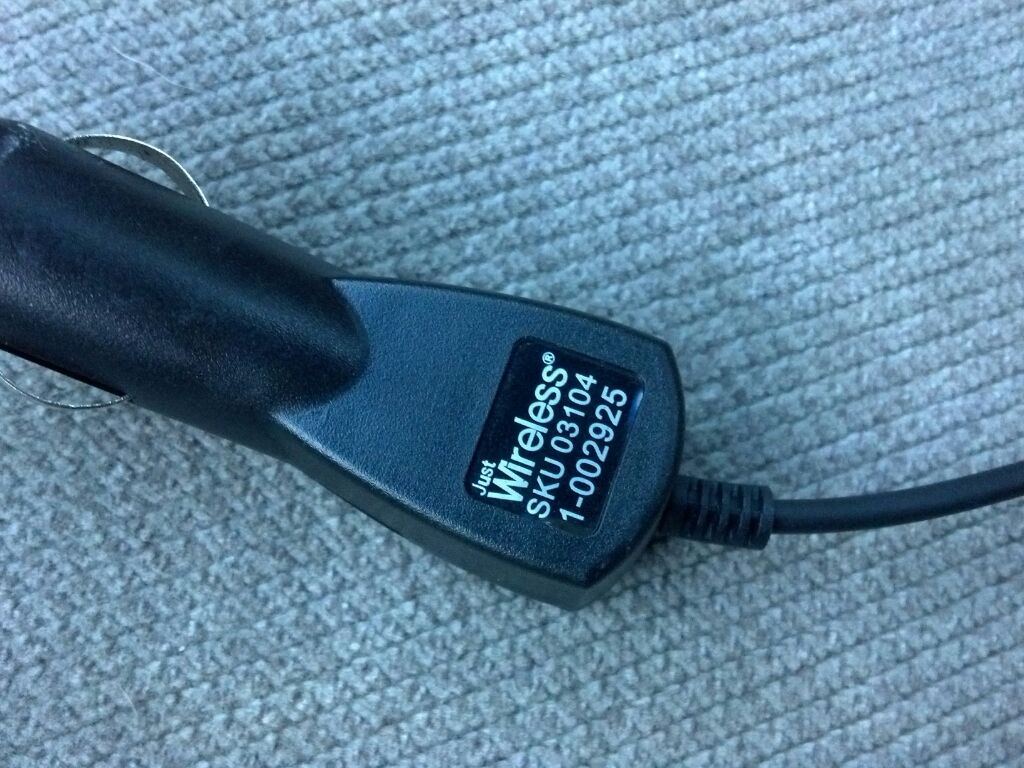

To be honest with you I'm using one from Walmart. I'll include a picture. I believe it was 10 bucks.
