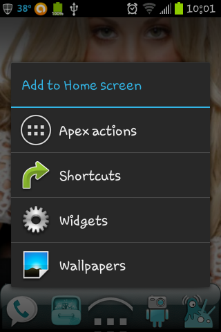

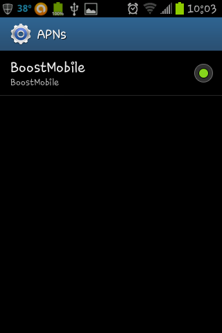

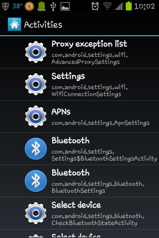

i know if you have apex pro launcher (not sure if the free one has it)or nova you can long press the home screen pick shortcuts then activities go down to settings select a drop box will open go to APNs select i mite open or put a shortcut on your screen so make sure a icon can fit on that screen when in that settings area you can enter the correct info i will add some screens in a edit
edit 2 :nvm i tried to change my setting to what shaunjohn listed and when i saved the settings area went blank so to fix back out go back in to apn settings hit the button left to the home button (menu)and reset to default sorry :(
edit 3 ok so i set permissions to the system folder to RW and was able to add an APN for the fields that we put BoostMobile i used all lower case it wouldent let me put shaunjohn MCC or MNC settings but it did let me put what i have in the screen shots and i selected the new apn . i tested it and it worked hope this helped
