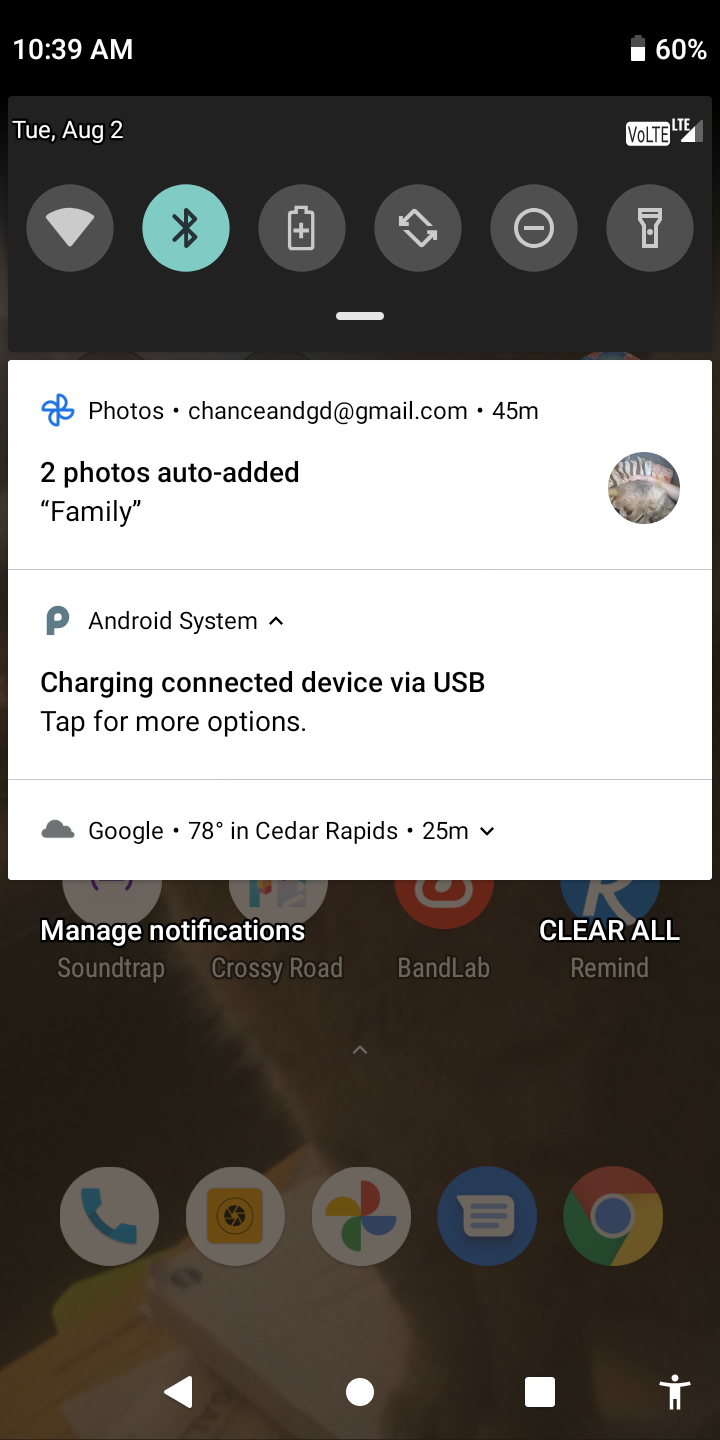

I have this charging via USB notification that has been going on since I purchased this phone (2 years ago) and I have been unable to find a fix for it it appears whenever I turn on my phone and it makes it so that I am unable to charge my phone the only time I've been able to charge it is when the phone is turned off or if I force stop Android system and then restart the phone. At one point I did manage to make the notification stop for like 2 months but now the notification is back and I don't remember how I fixed it, does anybody have any ideas?
Here's the notification

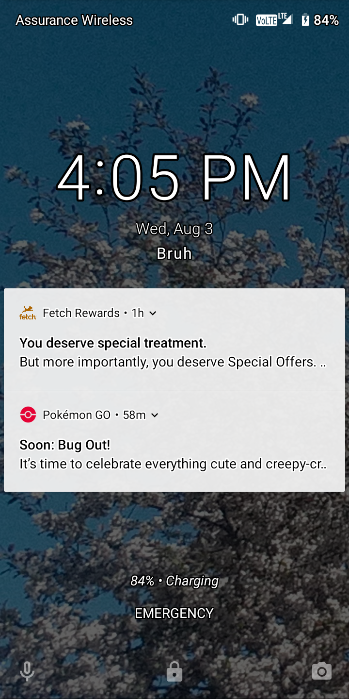

The one that came with the phone. Also,the p problem seems to have worsened, it's now saying it's charging on the lock screen and the battery symbol says that it's charging even though I don't have the charger plugged in right now
Android System - Charging connected device via USB - Tap for other USB options
