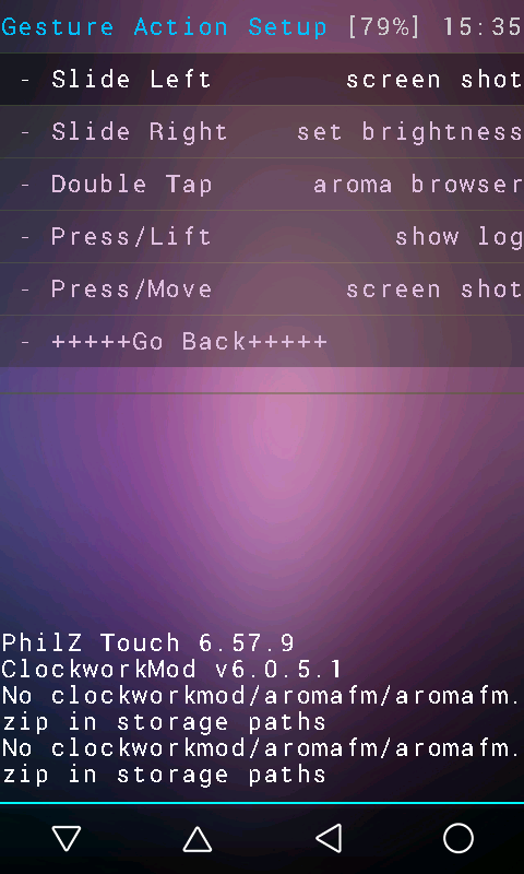

This recovery is for the LG L70 (MS323). It has been tested and works 100%.
DISCLAIMER: I am not responsible for anything that can happen to your device when using this. Your phone = Your responsibility. Your bootloader must be unlocked to use this.
NOTE: Some L70 devices have been reported to not boot to recovery with the device powered down, just a heads up for anyone that hasn't tried it. Be sure that your device is able to boot to recovery from power off, if it doesn't then restore your laf partition and you will have to unbrick if you brick instead of restoring a backup.
View attachment 80233 View attachment 80234

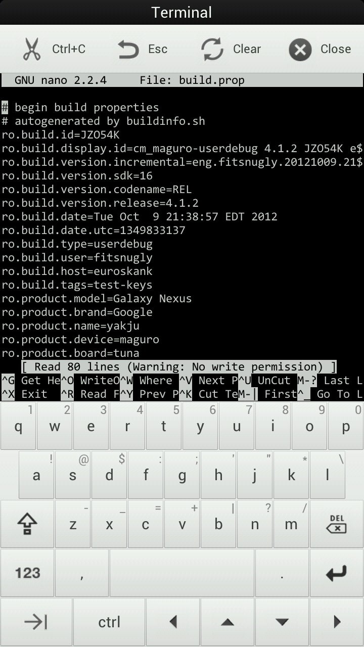

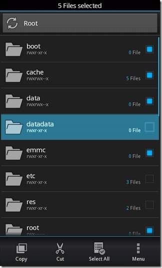

Aroma File Manager And Terminal
Aroma File Manager And Terminal is a lifesaver, allowing you to use a file manager and terminal right from recovery. It's even theme-able! Here are some screens:
View attachment 80235 View attachment 80236

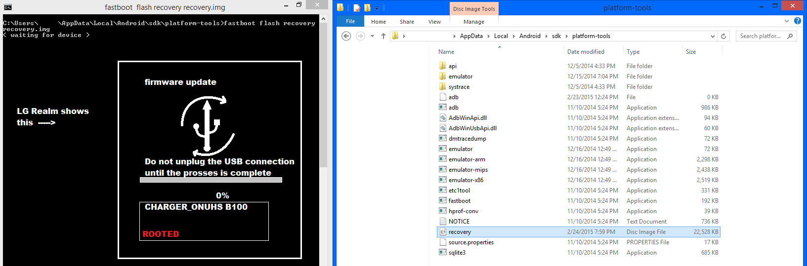

I am needing help going through these instructions for the lg realm
I get stuck with my phone reading"0%" and command window reading"waiting for device"(this is after i type my first command"fastboot flash recovery recovery.img")
I did skip the cd download code and used shift to open cmd in platform tools(see link in png)
would skipping that be my problem? and how exactly do i do that cd thing cuz it is not working for me.
