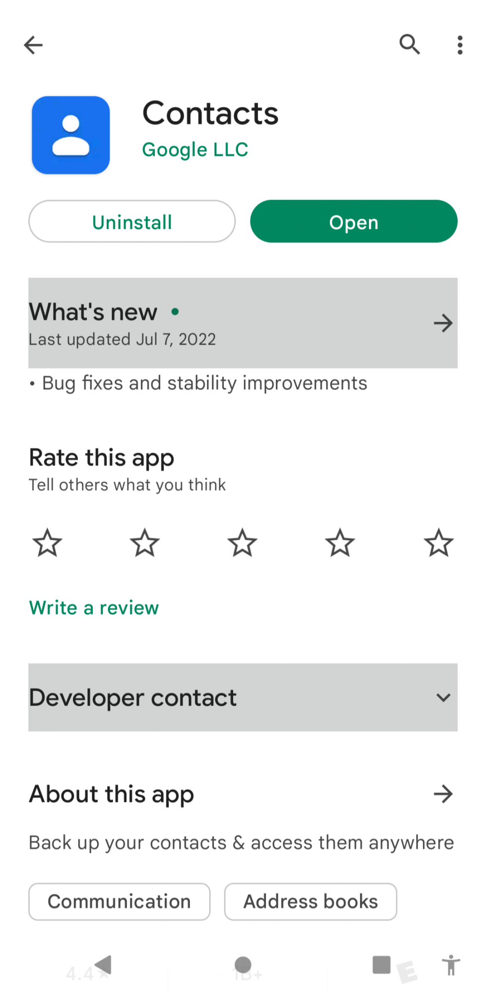

Jim, you also can use Google contacts in the play store, easy-pezy app that will save all of your contacts both on your phone and accessible on any device you use.... Screenshot_20220719-182424-007.png
Jim, you also can use Google contacts in the play store, easy-pezy app that will save all of your contacts both on your phone and accessible on any device you use.... View attachment 163341
Thanks Danny, I will come back to that after I exhaust the long process described for me earlier.
