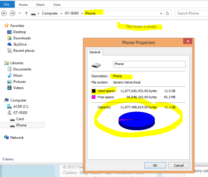

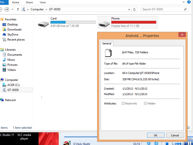

I uploaded a screen capture.
In the dialogue box is the properties of the Phone memory. It shows that altogether the size of everything inside 'Phone' is only 328MB but you can see the 11.1GB on top of it is full. :(

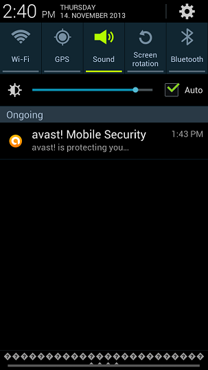

A screenshot of my notification roll.
What's with the <?> <?> <?> at the bottom of the picture? I understand that it is the information ticker on the lock screen which we can unable in settings but when it is unable, they should be gone but I still get this, which is annoying.
