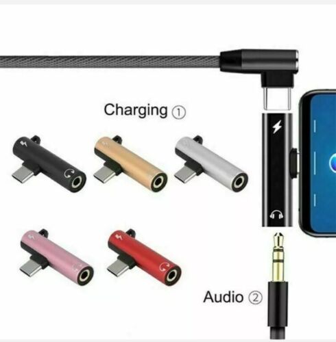

On my Blackview A90 I've tried two different types of USB-C headphone adapters that include a charging port. Neither charges the phone. Does anyone have a suggestion as to why, and is there a solution?
Ah, I see you misunderstand. There are USB-C adapters with two sockets: a jack for wired earphones and a USB-C socket for power pass-through. I've just bought one of these and it doesn't pass the power through. Neither did a previous one which had a different design. I was wondering why.
The problem could be the phone's USB type-C doesn't support simultaneous charging and USB audio output. It's one or the other, but not both at the same time.
For a solution, does the Blackview A90 have wireless charging capabilities, or use Bluetooth headphones with it?
Thanks for that response. I never thought of that limitation, you could well be correct. It doesn't have wireless charging. I could use my Bluetooth earphones, that is true. I think you've explained it.

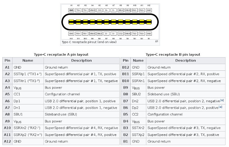

Any USB Type-C port has very specific, standardized wiring inside. There are metal contacts spaced out into a specific way inside the port that can only matched directly with the metal contacts in whatever Type-C plug that gets inserted. The metal contacts on the plug are also spaced out in a specific way correspondingly. The most important point being it is NOT a random arrangement, wiring that transfers audio signals or wiring that transfer power are not interchangeable. There are specified pins for power delivery and specific pins for audio signal transfers in both the plug and the port. If they don't match up exactly, the function (charging or listening to songs) won't happen. The wiring inside your phone isn't going to be a random arrangement, power transfers go to the charging circuitry and audio signals go the audio processor chip. You only see that USB plug as a unit but inside it there's a lot more involved.
In your instance, is sounds like those adapters apparently don't actually have the necessary power pins. Or please specify, are their 'charging' ports supposed to work as charging the phone (input) or for power delivery (output)? Are you sure they're not intended to be for data transfer only?

As the image I uploaded shows, these adaptors - which are commonly available - are designed to permit users to listen to audio on the phone whilst charging it.
