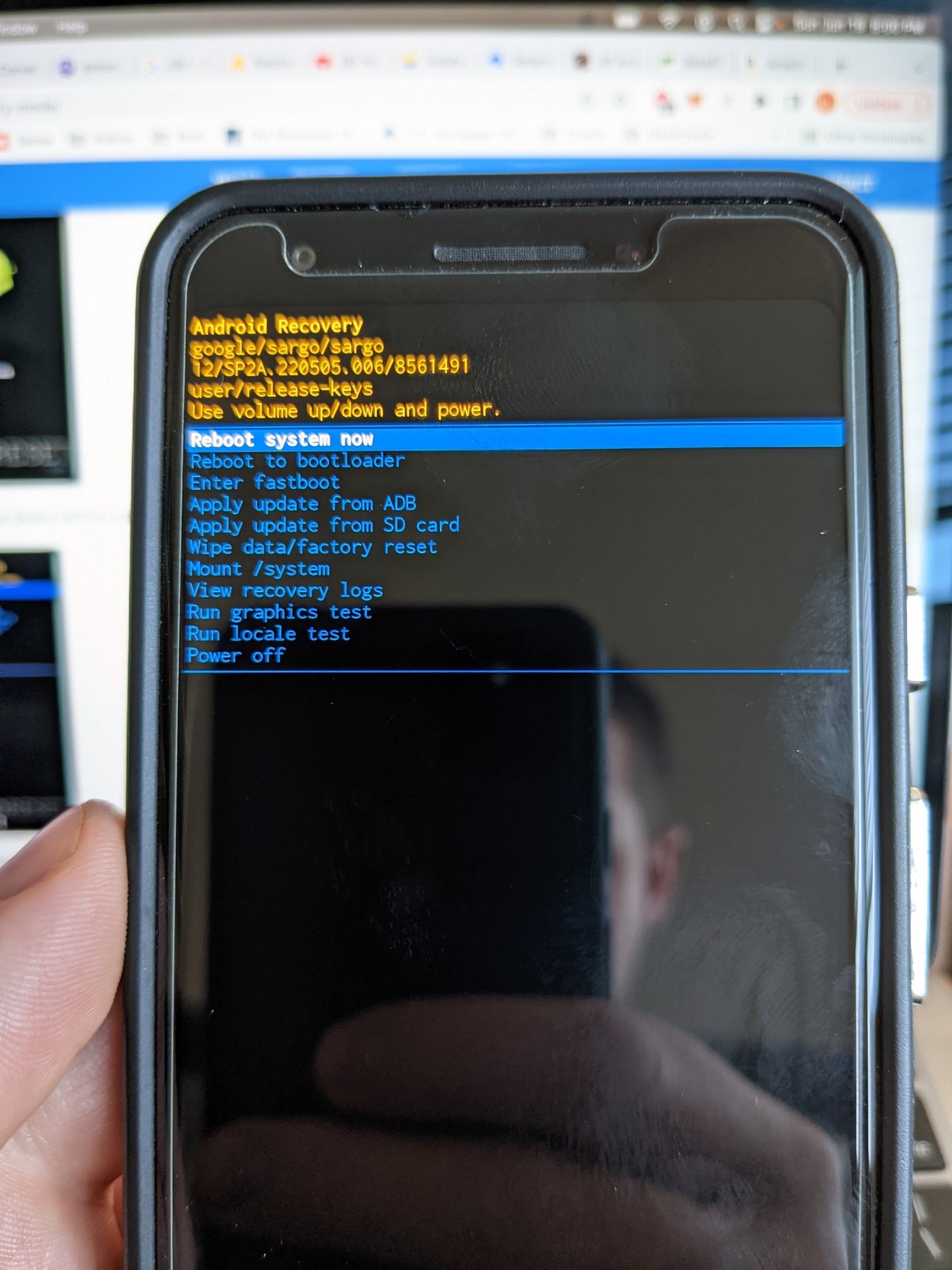

Interestingly enough when I boot into recovery mode following your instructions above I do not see the "wipe cache partition" option in the menu??? Any ideas?
More recent of versions of Android have stopped supporting a separate, dedicated system cache partition and are now just relying upon a system cache file instead. So at this point, some manufacturers do occasionally implement that 'old school' separate system cache partition, but most now use just a system cache file. Since you don't see that option in the Recovery menu, sounds like your phone simply doesn't have that partition.
So ignore my previous posting, it doesn't apply. That still leaves the charging problem you're having. Hopefully others will continue to chime in with better suggestions while my sluggish brain activity ponders over what might be going on.
