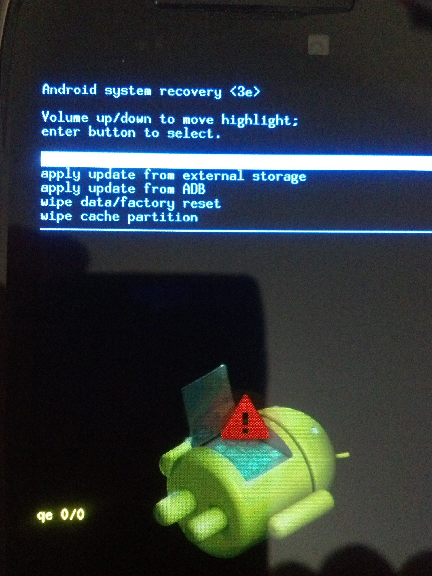

Stock recovery screen on phone will look like this
OMG that's the screen that immediately disappears that I can't read, then it goes to the android guy and I'm in download mode where it tells me to press volume up (I think) to continue, so I do
