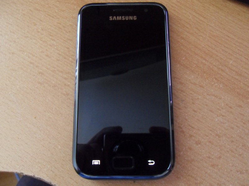

phone was rooted with froyo 2.2 "I9000XXJP3 version" using odin and also RyanZAEXT2LagFix ALPHA 1.
was fine until i turned it off as usual to charge over night. when i went to start it today it goes through the process of booting up then just hangs on a black screen with just the 2 soft keys illuminated all the time with a vibration every 2 mins...
tried to wipe data/factory reset in the clockworkmod recovery v2.5.0.4 menu
with no luck ?
see pics below
