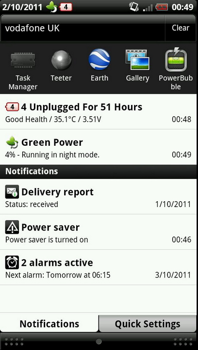

Try Battery Defender from INFOLIFE - I was getting about 10 hours now I get up to 48 hours with moderate usage. Get rid of Task Managers as well as they only duplicate standard Android housekeeping.

Well I do have my sleep time from 10 pm to 7 am with Battery Defender, and I don't have Sync on all the time, but I am still getting excellent battery usage
