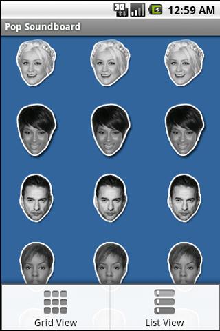

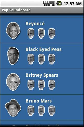

Hey people, i have made another soundboard using a similar design. Check it out. The POP SOUNDBOARD is a GREAT collection of your favorite singers and their signature sounds and phrases. 120 sounds from 40 famous singers. Choose your favorite ones, save them, use as ring tones alarm and notification signals with just 2 clicks.
