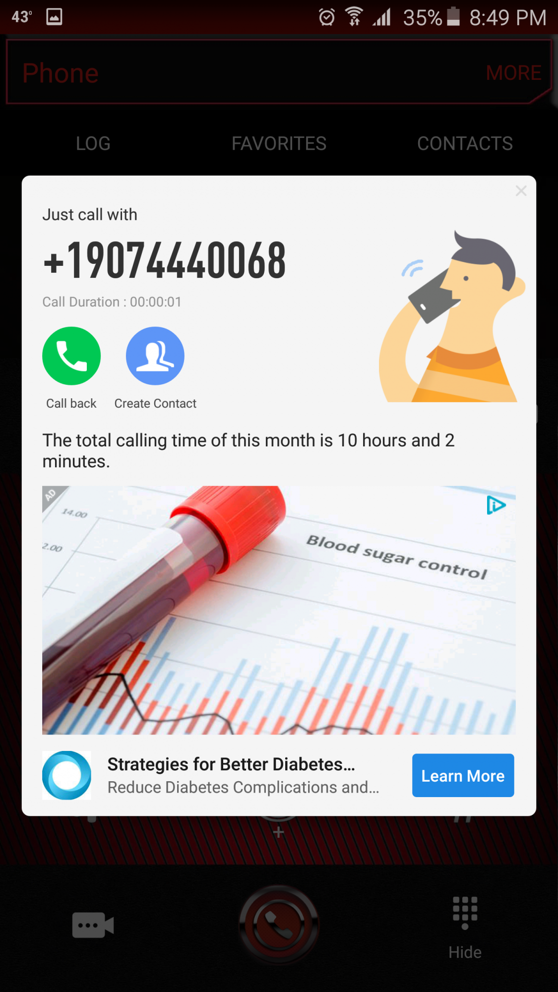

not sure what causing it but On my Note 5, after each call, i get a popup that reads "just call with" and then their contact name. theres a picture of a cartoon man on a phone, my call duration for the month and if my data is on, theres a random adchoices ad that is starting to really annoy me.

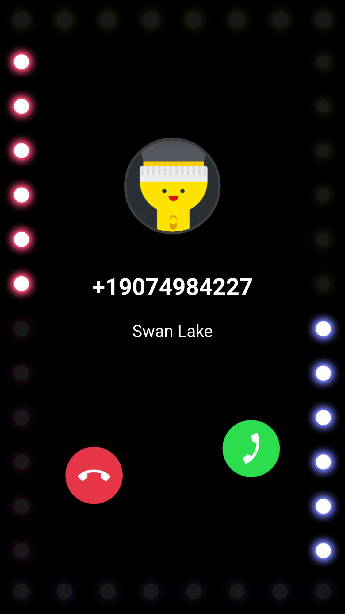

my incoming call screen also changed to a black screen with a bouncing green answer button.

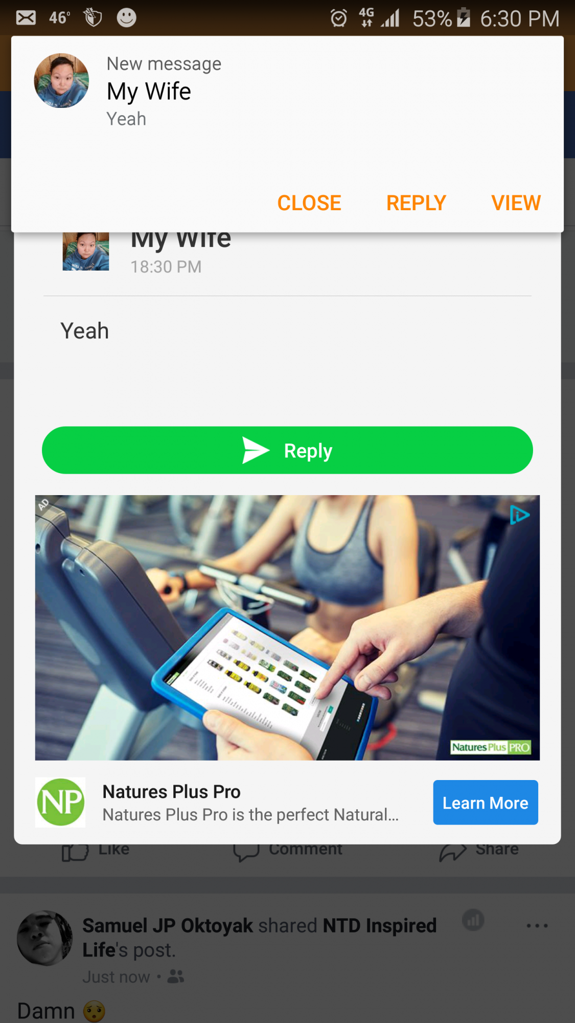

my incoming text messages trigger a popup too that has the same ad as the end call popup.

this pops up after every call

this stupid thing replaced my incoming call screen. im hoping someone will recognize it and let me know how to disable it.

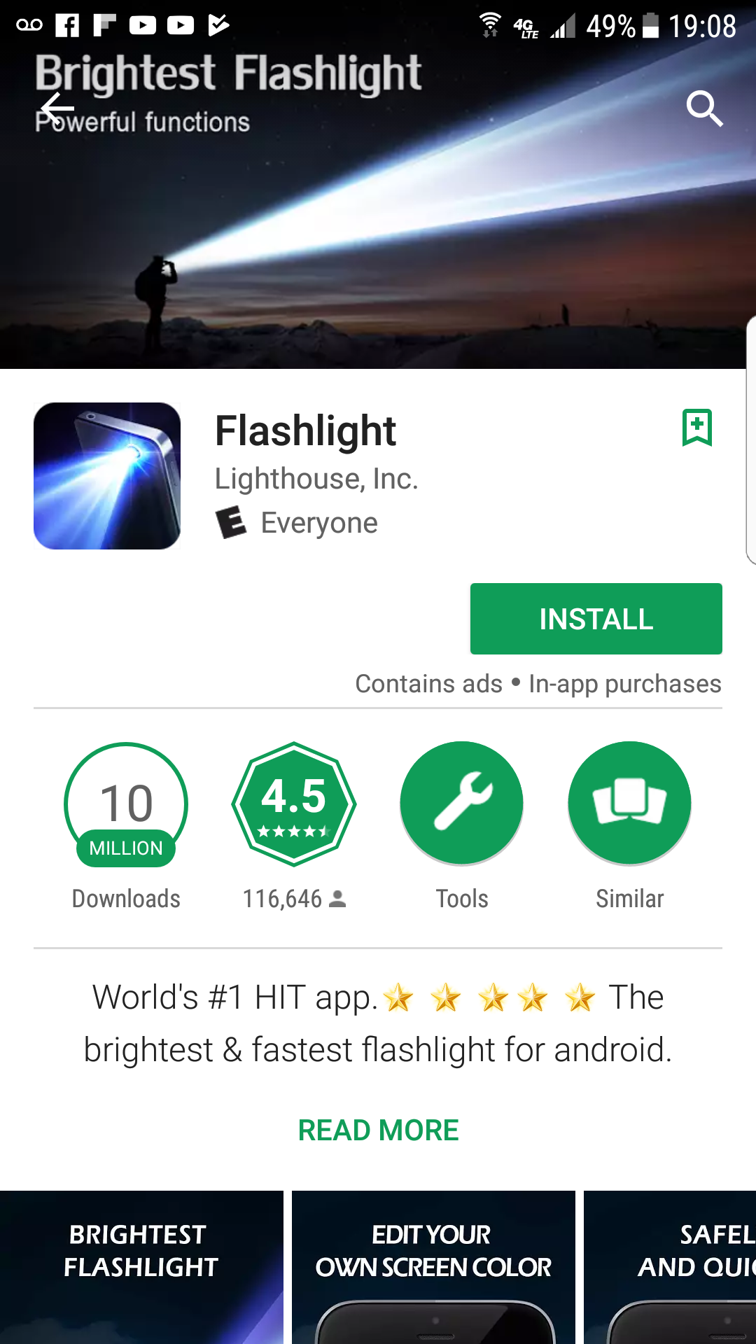

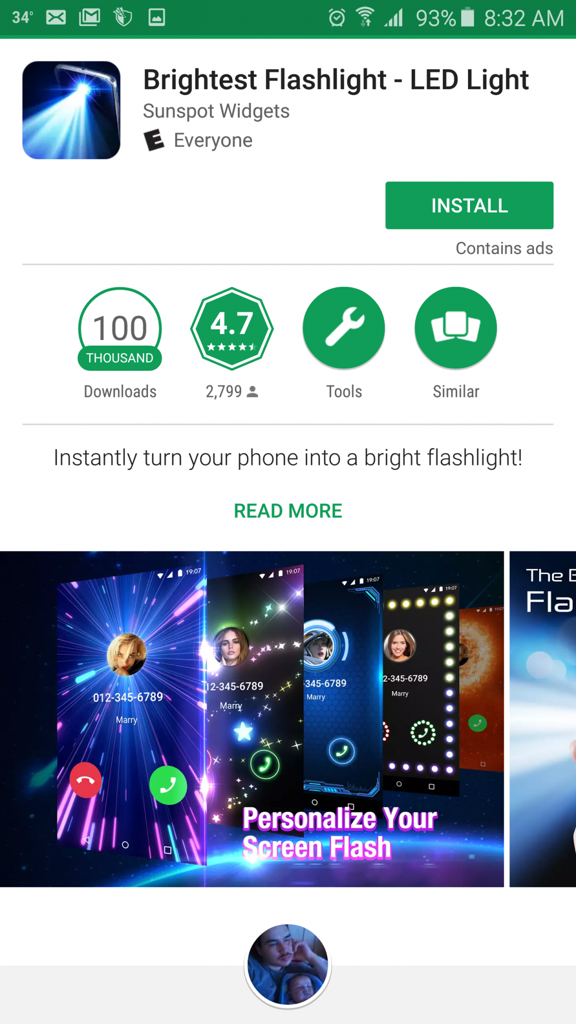

This is interesting, because I recently had similar issues adding a second "lock screen" overlay on top of mine, as well as popping up various ads. With some extensive research, I finally learned it was caused by an app named "Beacon Flashlight". And the sad thing is, I did not install it. This app CAME BUNDLED on my newly purchased LG V20 US Unlocked phone, which is totally factory stock, and not rooted. So was apparently put there by LG themselves! Removing the app fixed the problem. I have no idea why it was there, because this phone (and I suspect most phones to be the same) has more than one option to easily turn on the flashlight function of the back LED. No need for an "app" to do it.

Plagued me for 2 weeks and removed apps one by one. As others suspected, it was a flashlight app. It's gone now. App has an icon that several apps use, so I don't remember precisely which one. Not going to reinstall one to be sure. Looks like this.

This has been a problem that's been bothering me for weeks and I've finally had enough. I checked numerous forums and found multiple responses for which app is the culprit. I believe I've found a blanket solution that should work regardless of what app these annoying popups are paired with.
When you send or receive a text or call, the popup appears, in the corner there is the "settings gear icon", click that to open the actual app where it asks me to choose which flashcall light up display I prefer.
Once on that screen, press the "menu button" on your phone to open the list of running apps.
This will tell you which app the popups are paired with (mine was a QR reader), now you know which app to delete. Bingo.
