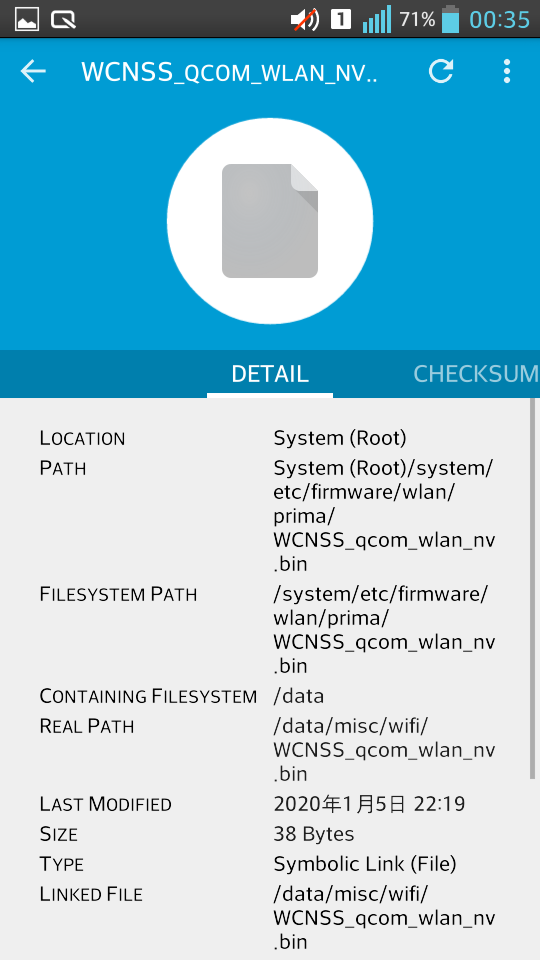

Hi, I did use the system/etc/firmware files from my stock rom already with no luck. I find a workaround which is to use the internet by bluetooth internet sharing from another device connected to wifi
Do you find any symlink file to the root /data fs? In my stock rom, I found some symlink files like this at /system/etc/firmware

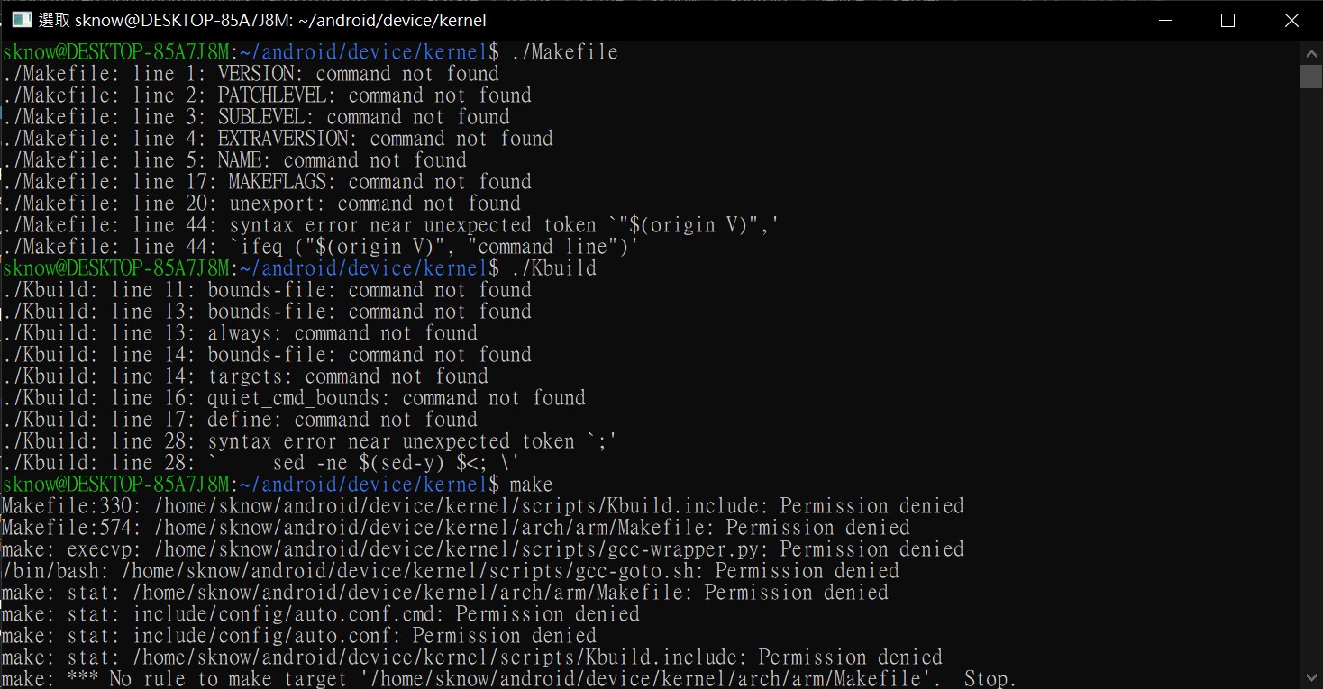

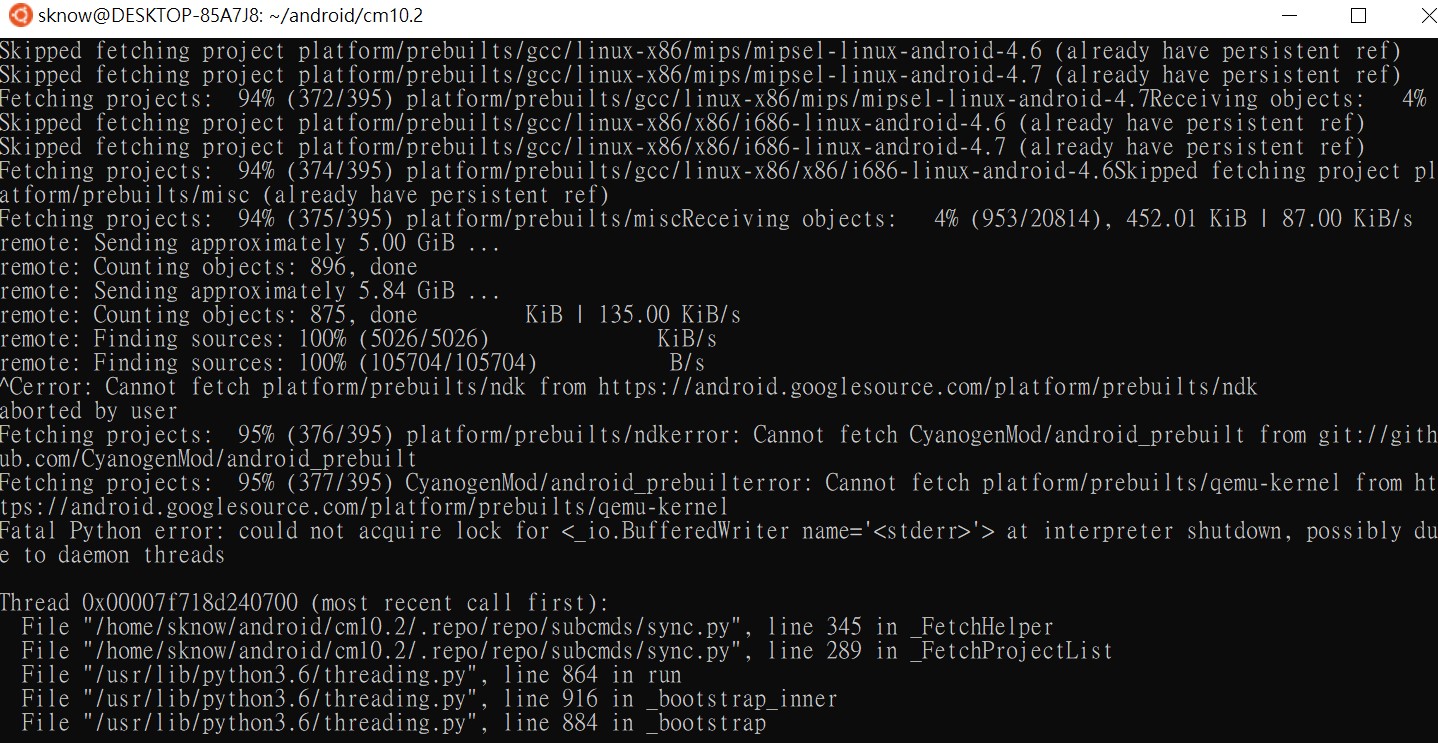

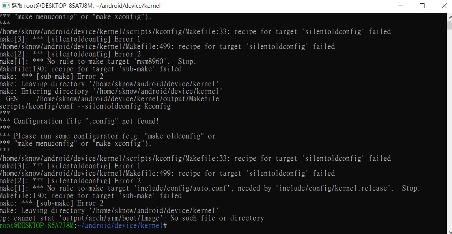

Hi folks, I know I haven't update for a few months. I am still trying to get cm source and create a bootable rom. For the time being I swith back to stock os of this old device. I am struggling to build my boot.img from the official jb kernel source. I hv encountered many error in Makefile.
I am struggling to build my boot.img from the official jb kernel source. Yes you're right, it is jellybean xd! I hv encountered many errors in GNU Makefile.. Any help is appreciated :)
