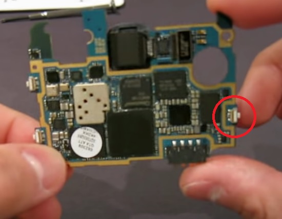

Can someone point me to a reliable vendor to purchase the power button for a Samsung S4? I want the small white toggle switch that is soldered to the board, which I circled in red in this photo.
I know Amazon sells used S4s (I got two S3's from them, an S4, and an S4 Mini) so you could potentially part one out (they only have tiny little screws holding everything together, not glue like a modern phone thank goodness!)
