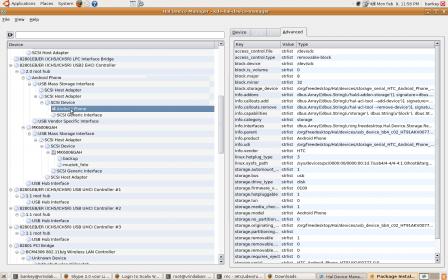

I made a udev rule :
SUBSYSTEM=="usb", SYSFS{idVendor}=="0bb4", MODE="0666"
I'll add a screenshot of devicelist & lsusb
Please if anyone can help me further then it would be great..
