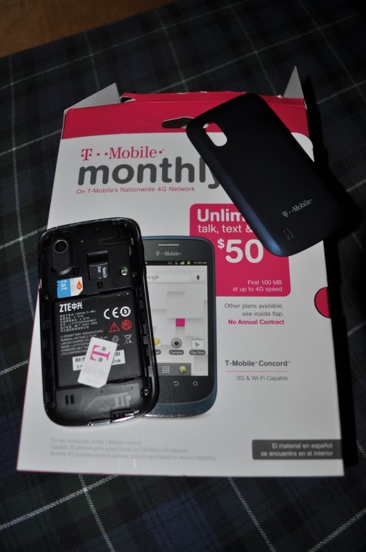

b) Remove battery to put in the AT&T (i.e., foreign) SIM card & replace battery

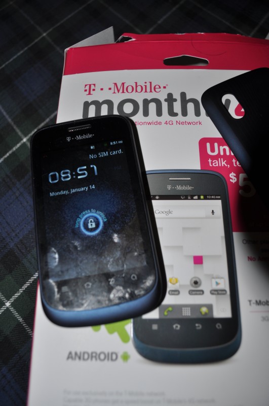

0. With foreign (AT&T) SIM card in place, I boot the T-Mobile ZTE Concord cellphone
1. This shows the "long press to unlock" screen, saying NO SIM card. Emergency calls only.

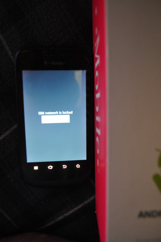

2. I long press & it says "SIM network is locked" "Emergency Dialer"

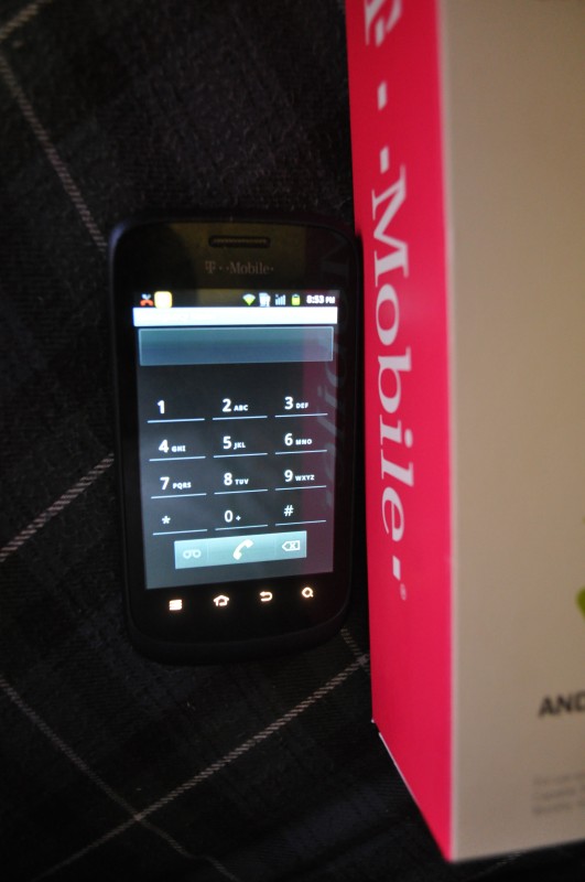

3. I press "Emergency Dialer" and it brings me to the Emergency Dialer

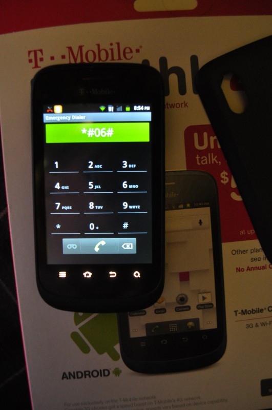

4. I type "*#06#" and it's supposed to ask for the unlock code, but it just sits there.

1. I put a very old (no longer active) AT&T SIM card into the ZTE V768 Concord telephone:
2. Then I booted to where it said "SIM network is locked" "Emergency Dialer":
3. I dialed "*983*258#" (here you see the shot just before the pound sign):
4. That brought up a simple "unlock password" screen:
5. Pressing in the empty field brought up a keypad:
6. I entered in the 8 digit unlock code previously sent to me by T-Mobile to my email:
