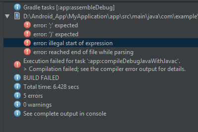

Im not sure why it looks different when I am using the "OnItemClickListener"
Any help would be appreciated. Thanks

I've uploaded a screenshot for you.

You have too many close brackets in this block

There are 3 "{" but 4 "}" Remove the one at line 9 above.
Post up your current code. I'll paste it into Android Studio and tell you what your compile problem is.

I corrected the syntax errors. Study the differences between your original code, and understand why it didn't work. Parentheses must match up.
