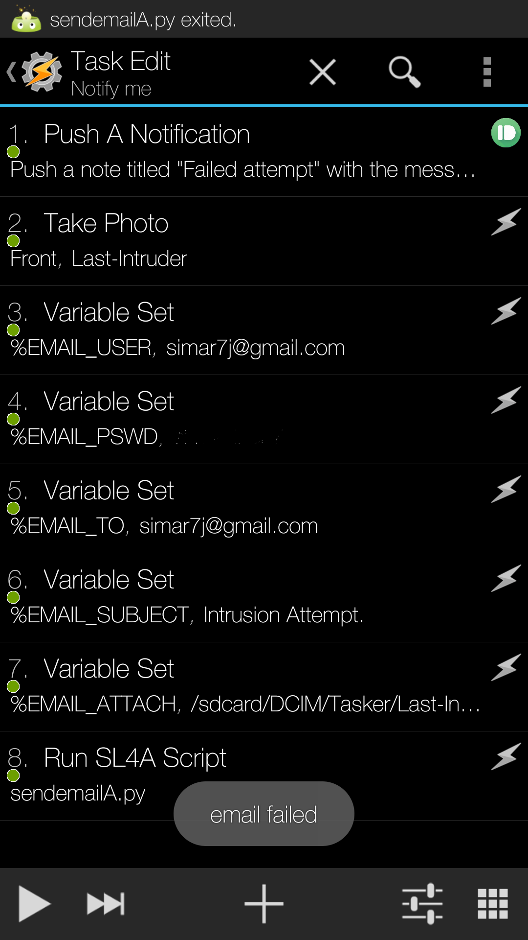

Ok i know bumping up an old thread but seriously need help on this. First I have read the entire thread line by line to see if I am not missing something before I post my problem. I initially download SL4A and Python3 for android, and what even I used to do SL4A was crashing, saying sl4a has stopped working. I thin uninstalled Python3 for Android and Downloaded just Python for Android (dont know which version is that), this stopped the crashing and script ran, but I get an error "email failed" ......
I am doing this by play button just to see first all steps are working ...... now the gmail account I am using does not have a 2 step auth, so I am running short of idea why I am getting email failed. Attaching screen shots to provide more information. I have removed the password, in paint but there is a password there in the field.... as you can see in the screen shot all steps are green and I have a message of script executing and exiting as well but then I get "email failed" response
Please request anyone to help me out here ...... Let me know if you need more screen shots
Regards
Sammy
