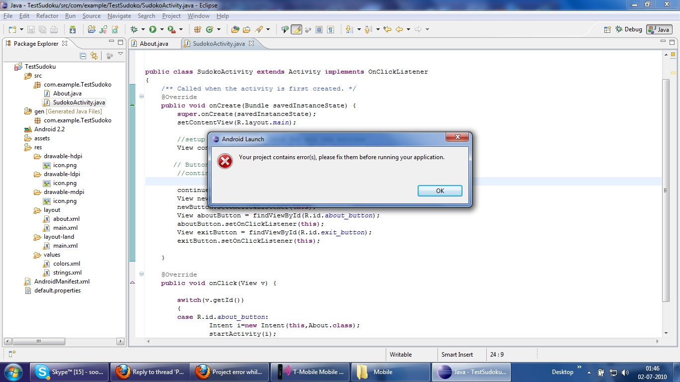

I am doing a sample project it was running fine till few hours back but now when i run it it won't run just says "your project contains errors. please fix them before running your application". I can't figure what from where the error is generated. Can some one please tell me how i can figure out from where the error is coming.
I am using Eclipse.
I have attached the code. Please please some one help

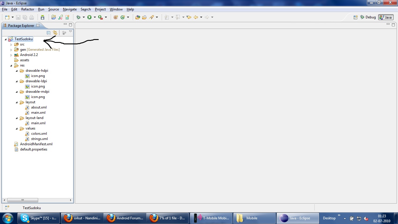

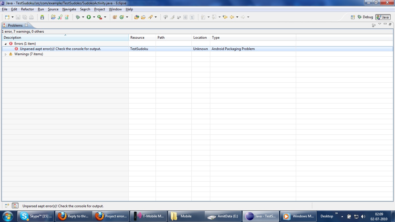

I am attaching the error message and and the red cross i m seeing. Please see and advise

Whenever I get an error that doesn't seem to have any reason for it, project -> clean fixes it.
i did the clean thing and it got rid of the red cross sign from the root folder of my project but i can see a new error in the console window which says "[2010-07-02 02:28:20 - TestSudoku] Could not find TestSudoku.apk!

Keep scrolling up through the errors. You've posted the end of the aapt usage. Somewhere higher up you see a line "Android Asset Packaging Tool". Above that I would predict there being an error line that caused aapt to output its usage. What is that line?
