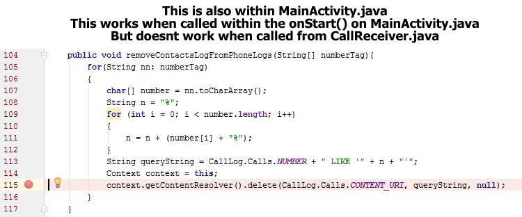

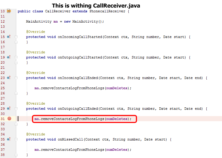

So I was able to setup the sample code from the link, finally got it working to the point where the app would acknowledge calls. I add my method within the onOutGoingCallEnded, it gets the list of numbers, but doesn't work, doesn't delete anything no matter that while stepping thru the code, it does go into the delete routine and loops thru but nothing is deleted. Below I have attached screen shots of the code and where I'm making the calls.. ive tried to keep this simple to start off and will improve once it actually works.. Can anyone see why it works when called within the MainActivity and not within the CallReceiver
Yea so I keep stepping thru the code and letting it run without interruption and when called from the CallReceiver.java it never loops thru the list of numbers, it only attempts the number that was called, so it seems like even though I'm passing the list of numbers to the routine, the actual number called is what is being passed in, but even then it doesn't delete that call, which is one of the numbers in the list.
What am I doing wrong..

You have not shown how the numDeletes array is initialised within your code, so it's not possible to explain why this is happening. If you would like to post the full code of CallReceiver then this would help.

Java:
package com.personal.calllogadmin;
import android.content.Context;
import java.util.Date;
public class CallReceiver extends PhonecallReceiver {
    MainActivity ma = new MainActivity();
    @Override
    protected void onIncomingCallStarted(Context ctx, String number, Date start) {
    @Override
    protected void onOutgoingCallStarted(Context ctx, String number, Date start) {
    @Override
    protected void onIncomingCallEnded(Context ctx, String number, Date start, Date end) {
        ma.removeContactsLogFromPhoneLogs(numDeletes);
    @Override
    protected void onOutgoingCallEnded(Context ctx, String number, Date start, Date end) {
    @Override
    protected void onMissedCall(Context ctx, String number, Date start) {
    private String[] numDeletes ={
            "8555553493",
            "2222229896",
            "2222225005 "
So this is what is currently there, granted the variables expected by the override methods expect just string, I'm not looking to pass those since my removeContactsLogFromPhoneLogs already handles the deletion. So I'm passing the string array of numbers from the callreceiver just as if I was calling it from within the main activity but only when called from mainactivity does the routine actually loop thru the list and work.
I find it odd that you are creating an instance of your MainActivity within the CallReceiver class.
If you're creating this just to invoke the removeContactsLogFromPhoneLogs() method, then the Activity class is the wrong place for this method. Normally the usual architecture is to create a database helper class, which contains all methods related to database access.
As to why your code is not looping over the numbers in your numDeletes array, I would set a breakpoint in onOutgoingCallEnded(), and verify that the array actually contains any numbers. Step through the execution of the code line by line, into removeContactsLogFromPhoneLogs(), to check exactly what is going on.

Well thats the thing, if i could record the step thru i would post that, the routine works BUT only when called from MainActivity. When called from callreceiver it doesnt work, it will get to the first line in the loop
for (String nn : numberTag) but never actually gets into the loop, it literally steps out of that and continues..
I have breakpoints within the loop itself and it just gets to the first line and continues outside the loop(when called from callended method)
So i know that the loop works and is not the problem.
