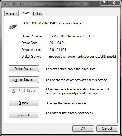

To consider...
... wouldn't the fact that the end result is virtually the same as the end result from doing the original procedure (OP) indicate that the very latest Samsung drivers do, in fact, work for the Note II

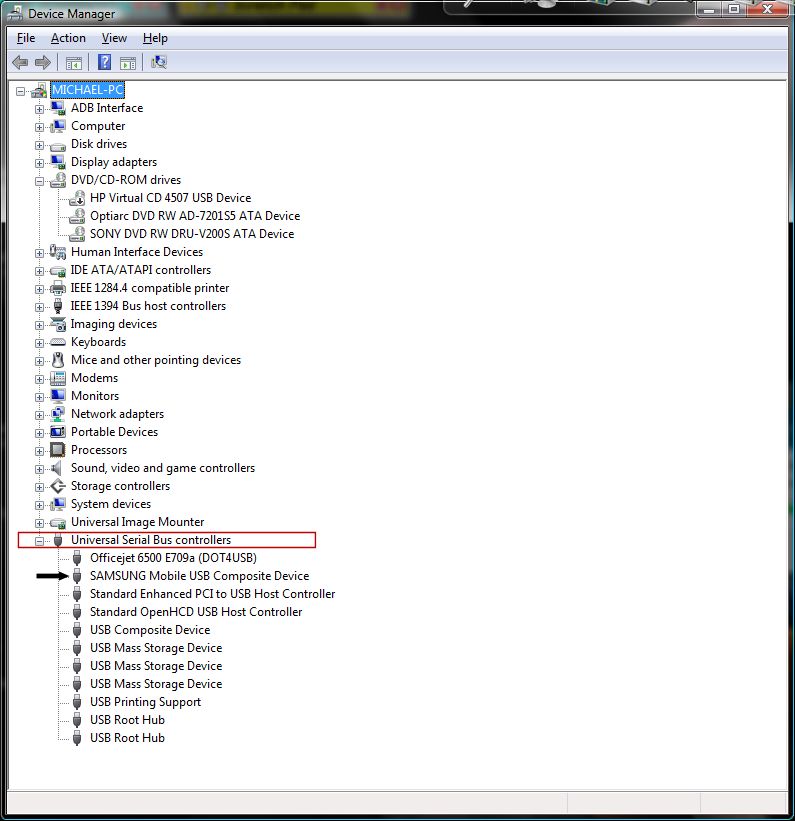

I admire your investigative fervor :)
Call me a computer noob, but I just tried looking for my driver version in Device Manager and cannot find it :o
Mikestony,
Understandable, it isn't obvious at first!
Once in the Windows Device Manager, the USB-related stuff is at the bottom, but you have to expand the group to see what's in it. When you do, you'll no doubt see the Samsung driver... check out the attached image from my desktop.
Then you:
I'll have to check when I get home.
Or I suppose I can do it here at work.
Perhaps I didn't see it because my device was not plugged in?
At work I'm on Windows 7 Professional 32bit.
At home it's Windows 7 64 bit.
Anyhoo, I hope you can see this...this is at work:
