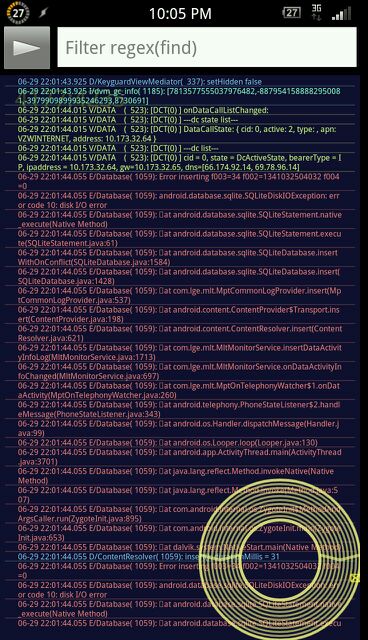

So finally got some time to go back to BO and have installed kyrologcat on the device. I think I've got a text file with a reboot but not sure where to go from here. Still getting reboots but only when I the processing on this thing. Any help?
Sim sync error. So it should save those logs in the folder on your sd card... Check to see if it's there. That screenshot doesn't quite say what triggered the call for the sim card.
Wow, I went over that logcat you sent me. Your phone is CONSTANTLY working/running, which is weird and there are a ton of database errors.
You have a reoccurring database error "android.database.sqlite.SQLiteException" and the LG MLT app seems to be throwing some errors. What's concerning is NO ONE on the interwebs seems to know what this damn app does. It appears to be a system monitor app, so it *could* be frozen. But please note, I don't know if freezing that app will lead to other issues (like when you freeze 'messaging', you can't send mms); if you start to see adverse reactions, unfreeze it.
Yeah I was thinking there was something screwy going on. Thanks for the help. The sqlite data error seem to be the biggest one sending errors. Not sure how to deal with that...ill try to freeze that app though. To fix ALL of this I'm thinking I may need to go back to v4 update to v6 and then try BO. I think one of the problems is all that working is causing my phone to overheat and then reboot. Im sitting over here wih a bag of ice kn thia thing to bea able to write this without a reboot. Lol. Quite the mess.

Ditto on the SQlite errors, and the log cat goes bonkers non stop never pausing.
Several of my log cats can be found here:
Joelperryproductions.com/spectrum/logcats
If I catch the reboot, I save a logcat as soon as the phone is back up, so the cause should be near the end of each file, with the build up to the issue coming before it.
