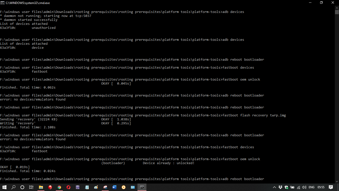

I tried to root my realme c1 device using adb platform tools. I did it successfully until the last step. But when I tap for sytem reboot in TWRP recovery mode finally, it got directed to start screen of fastboot mode. And after that my phone got stuck to that screen.
I tried giving command from adb tools. There, my device was shown in the list when i give the command 'fastboot devices' but when i gave the command of 'adb reboot', it is saying 'error/no emulator found'. Even if i press power button for long time, it's not helping. I am attaching the screenshot of my command prompt activities using ADB tools

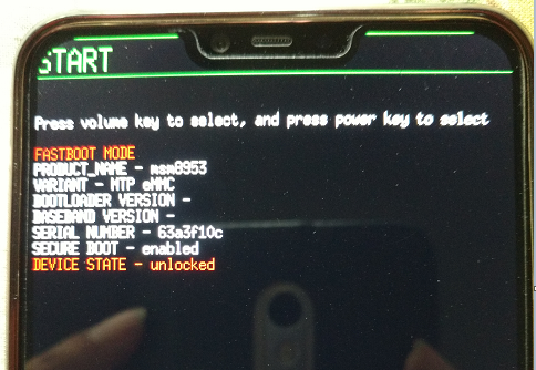

. Also attaching the fast boot screen to which i am stuck to. How to get rid of that screen and to get back my phone in normal condition?
Plz help anybody..

Not familiar with that device but have you tried putting the recovery.img in your working folder.
Then trying fastboot boot name of recovery.img ? Not sure if it'll work for you but no harm no foul if it fails.
Hi James, i tried what u suggested but it's saying 'command failed' (see attached picture). One good thing is that your method atleast makes the logo of my device manufacture stable which i didn't get in any other method that I tried before.

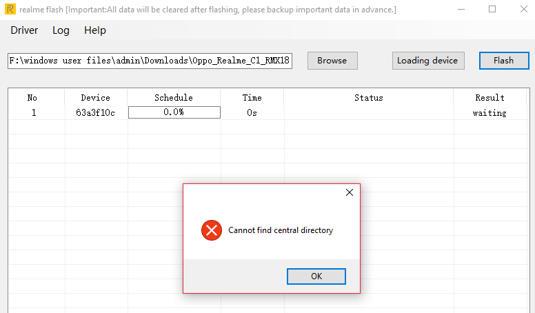

Also tried flashing stock rom using realme flash tool but that also says, 'cannot find central directory' (see 2nd picture).

Hmm if you can extract the recovery.img from the firmware you could try fastboot flashing it, the stock recovery. In theory since no changes were made other then an attempt to flash TWRP it should boot up
i tried to extract the ofp file using easy jtag, ufi and miracle box but didn't succed. I think i need to google more. Any other idea?
