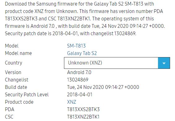

On the download screen of the Tablet it had SM-T813 as the model number.
The friends bought the Tab from Noel Leeming in New Zealand, so when looking for the right PDA file the one that looked like it might be the correct one, was the one I downloaded. The other one it might be is the Australian version. Have approached Noel Leeming to see if they know of the country of origin if that helps.
I installed T813XXS2BTK3_T813XNZ2BTK1_HOME.tar.md5 from SamMobile (see attached screenshot for details).
When using Odin, I thought I was only installing the PDA file as this was the only box that was ticked.
Could it be possible the CSC file was accidentally downloaded too?
