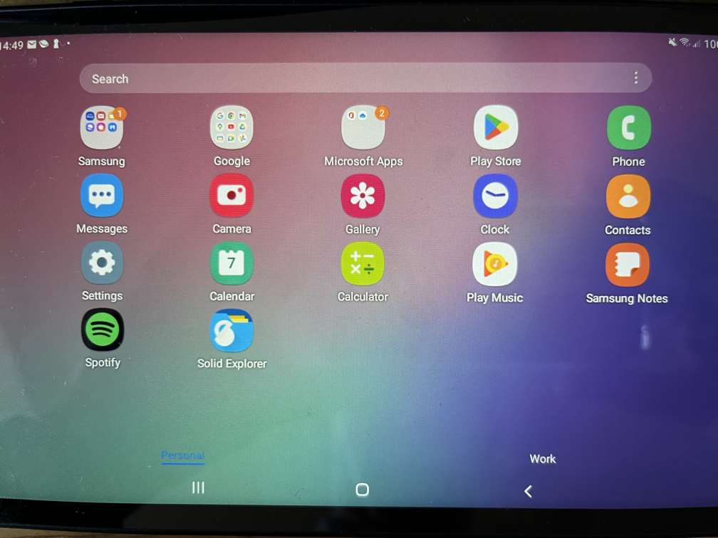

Somehow, in my setup of my Galaxy Tab A, I ended up with two sections to the main display: Personal and Work. I don't need this separation, and I find it inconvenient. Can someone please tell me how I can remove this feature?

Can you post a screen shot of your screen?
I don't remember all the setup steps, but I do have a few Google apps installed.
OK, so your home screen is controlled by the "launcher"... Which shows you your app icons.
You can long press on each and drag to the trash or delete from the home screen as you wish. If you swipe up, down or sideways you can see all of your app icons in the app drawer, where you can long press on one, and drag onto your home screen.

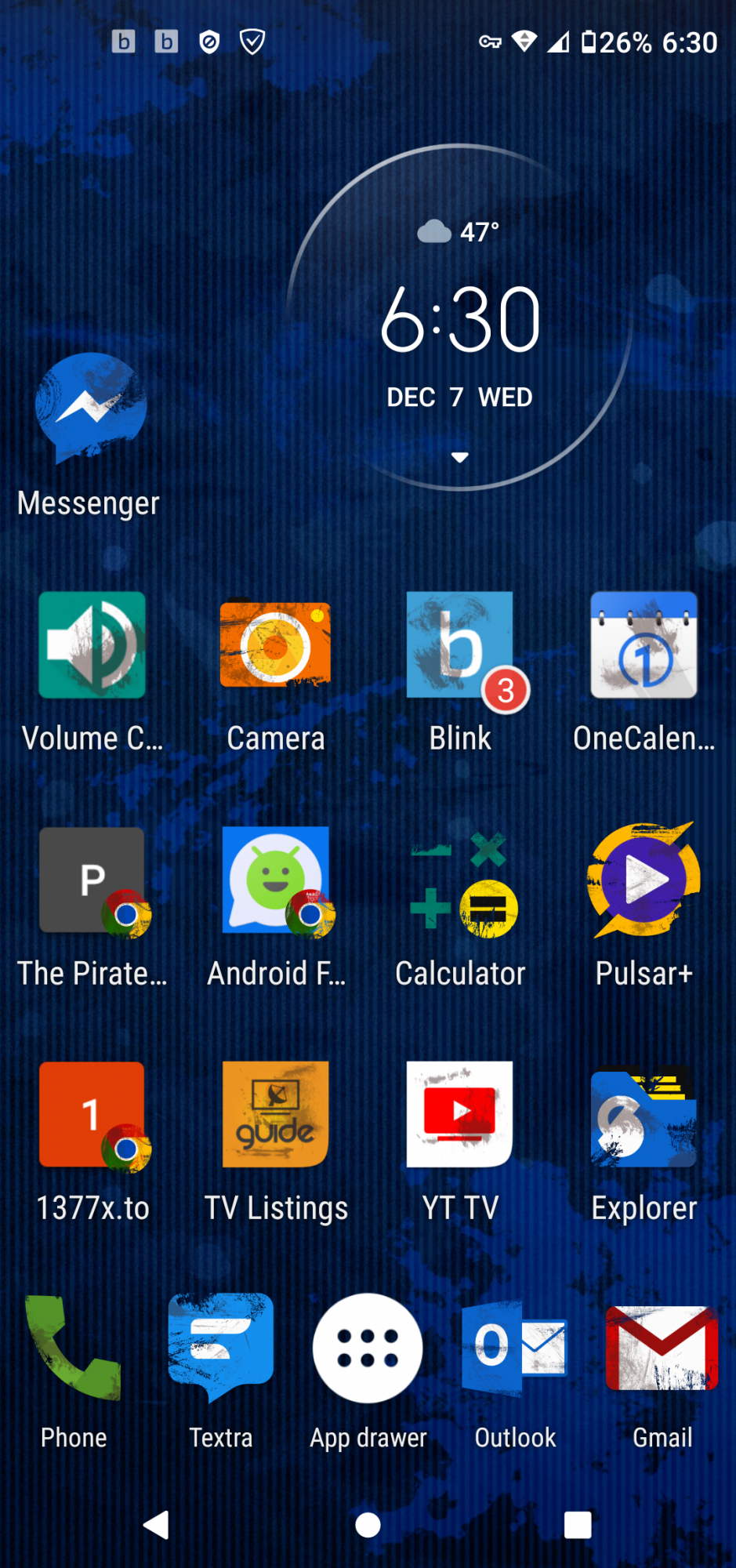

You can even install a different launcher from the play store, such as Nova launcher, which is what I use, and you can install totally different icons for your apps. Here's my screen...

Go to settings, accounts and remove an account that is associated with your work profile.
