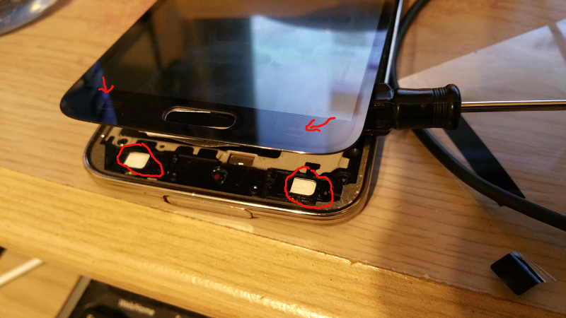

Definitely not the cable, or the connector. I checked all that. I made sure it was snapped into place (about 5 times). It looks as if the sensors for the back button, and recent app button are NOT
part of the digitizer, but part of the phone, (as shown in the picture provided). The 2 white squares.

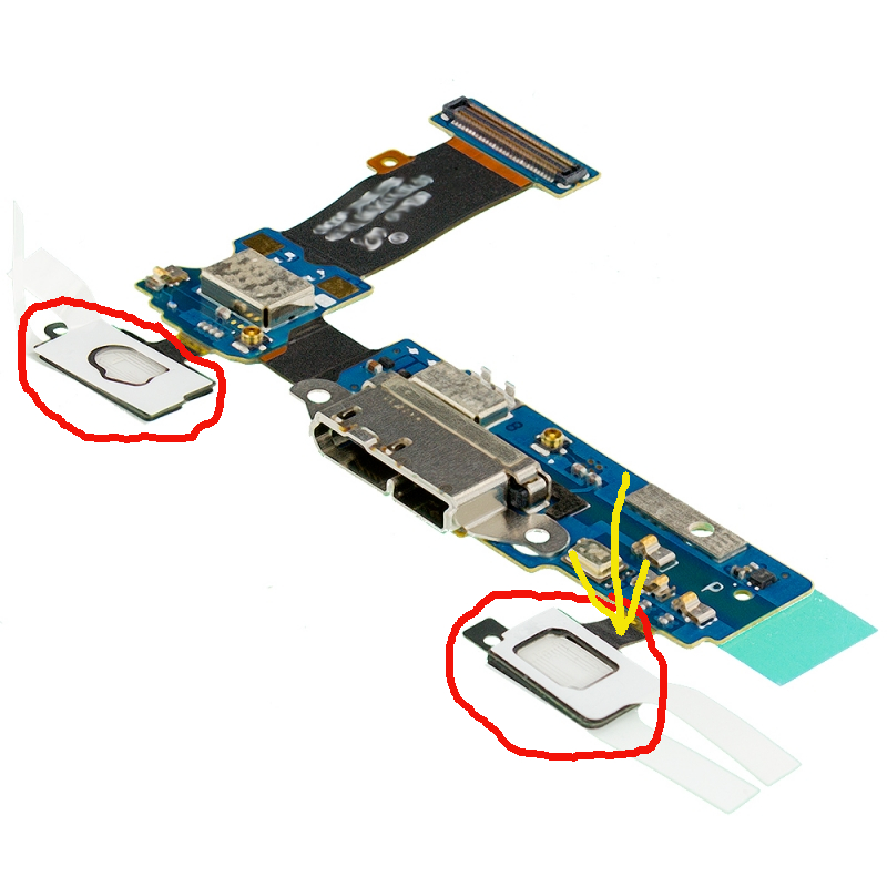

OK, I figured it out. When I removed the original screen, which was shattered. I accidentally broke off the 2 connectors for the "Back", and "Recent Apps" buttons, which are built into the charging port. See image below. They both snapped at the black ribbon, (where the yellow arrow is pointing). I just ordered a new charging port off of Ebay, and that should fix my problem.
I hope this helps anyone else who made the same mistake as me.
