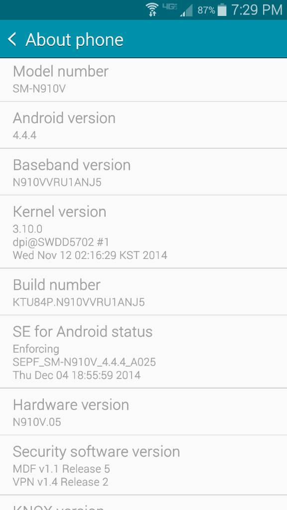

This is my note specs.
I have downloaded all the OTAs from Verizon except for this last little one
I don't understand what you're trying to say. If you indeed downloaded all the OTA's (less the last one), then your phone should be on LP. Are you just saying your phone downloaded them and you didn't install them?
Now the bad news... In the last updates to OF1, Verizon incremented the bootloader from #1 to #2. According to hsbadr, a very respected member of XDA, if you have taken the latest updates to OF1 via OTA, you will not be able to revert back to either OAF or KK.
Yeah I took all and any of the downloads that verizon sent out OTA. I'm on (N910VVRU2BOF1). which according to your info and my research means I am SOL. THANK YOU FOR GIVING ME THE CLARITY I was seeking.
