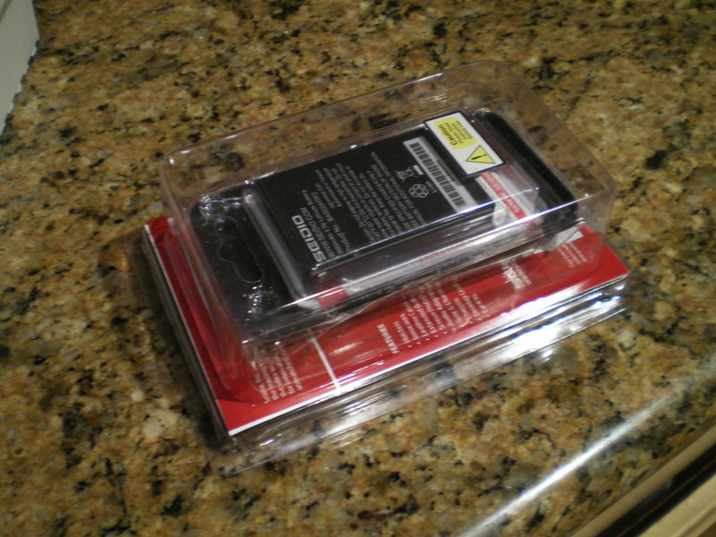

Disclosure: I was sent this battery by Seidio to review. I accepted with the stipulation that I could write an objective review (mostly numbers). Notice that I'm putting the disclaimer at the top; I don't want people accusing me of anything if I put a disclaimer at the bottom.

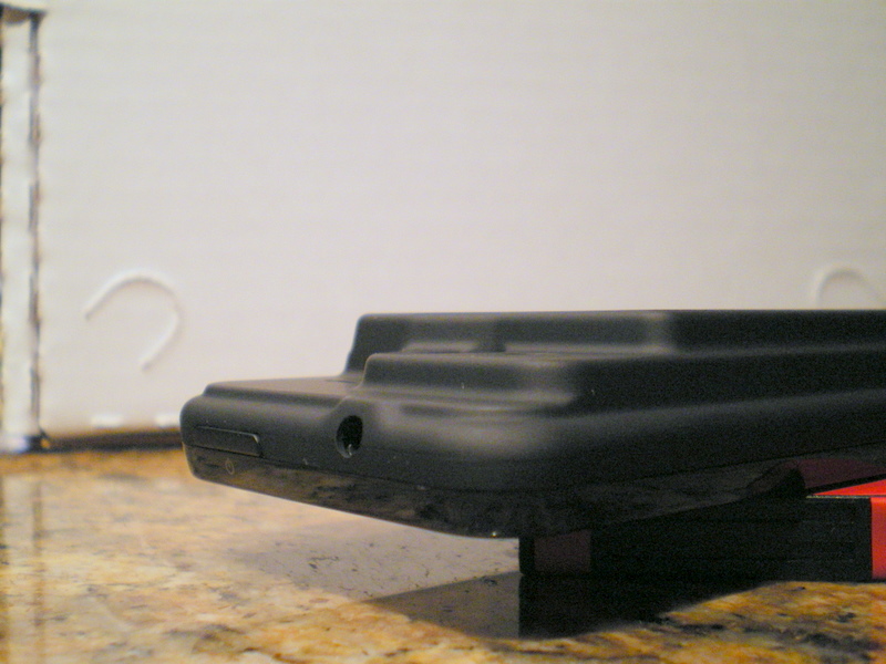

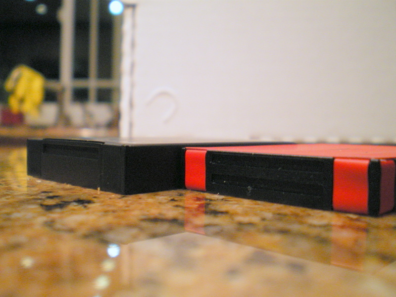

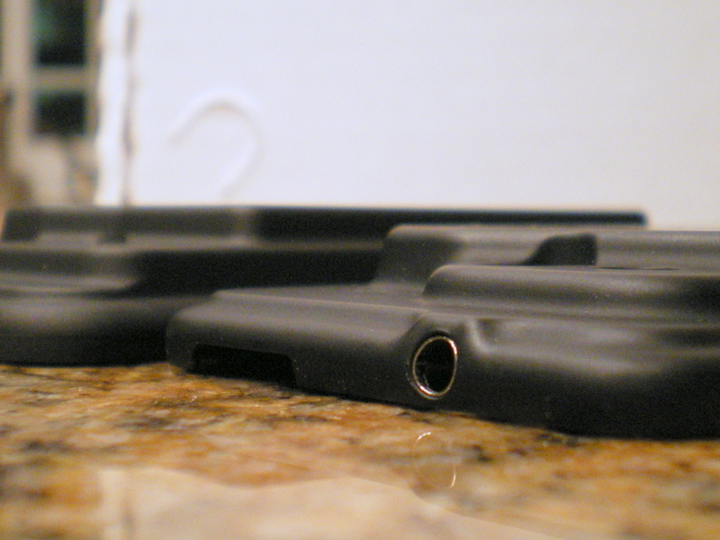

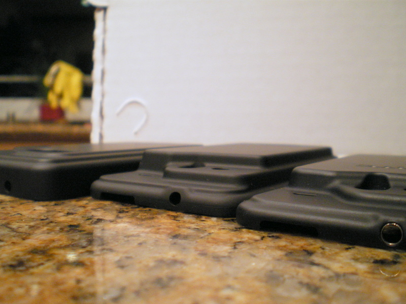

- In the pictures with two batteries, the red battery is the 2150 OEM, the other is the 3500. Notice the 3500 is barely over 1 mm thicker.

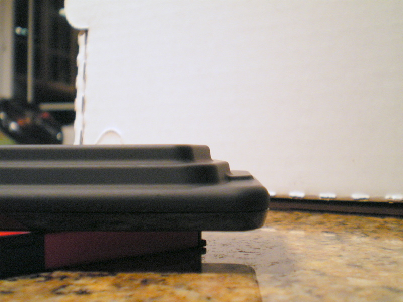

- In the pictures with two cases, the one in the foreground is the 2150 OEM back. The other is the 3500 back. Notice the difference in design.

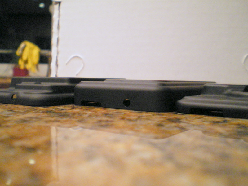

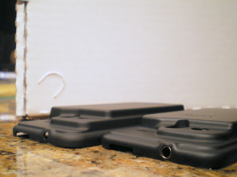

- In the pictures with three cases, one is the 2600 back (flat), the others are the 3500 and 2150 backs. The picture with the flat 2600 back in the center has the 3500 cover to the left and the 2150 to the right. The picture with the 2600 back cover to the far left has the 3500 cover in the center, the 2150 to the right.
- In the picture with the phone with 3500 back cover on and on top of the red battery, I put a white background so you can judge the cover's design better (more contrast). Hope it helps.
- Notice the 3500 back has one extra "step" compared to the 2150 back. It actually feels better in the hand than the 2150 back cover.
- The 3500 actually fits inside the 2600 back. This is my preference, but the 2600 back I could not find a suitable case for.
I bought a hard silicone case from Fommy and cut out the back to accommodate the 3500, so essentially the case has been turned into a protective "frame." I'll try to take pictures of that and post it as well.
