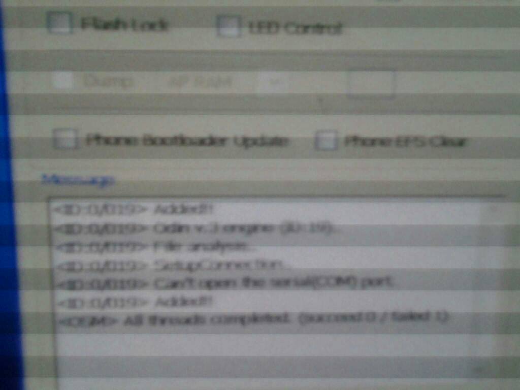

Well I thought I had Cwm because of the yellow square...but there could be a solution if somone could flash the OTA back to 4.0...but still no luck for me
the yellow square is there because you have flashed custom firmware. it doesn't mean you have cwm. just use odin to reflash cwm and then flash the su zip and you're good
Tried still no luck..
