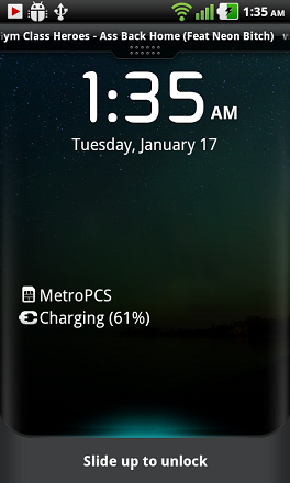

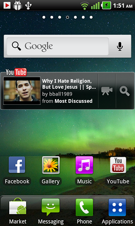

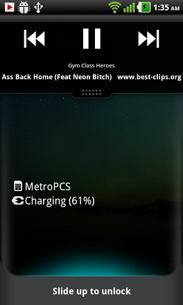

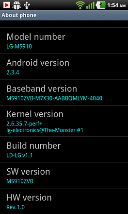

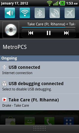

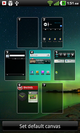

This is a Stock deodexed rom for LG Esteem with slight modifications to the 'stock' theme.
Rom Includes:
Plague kernel(Thanks PlayfulGod)
Stock Metro/LG theme & Launcher
Removed ALL MPCS Apk's
Root permissions
Lightning fast!!
W.I.P. more updates and features to be added soon
plus will make flashable themes soon...
