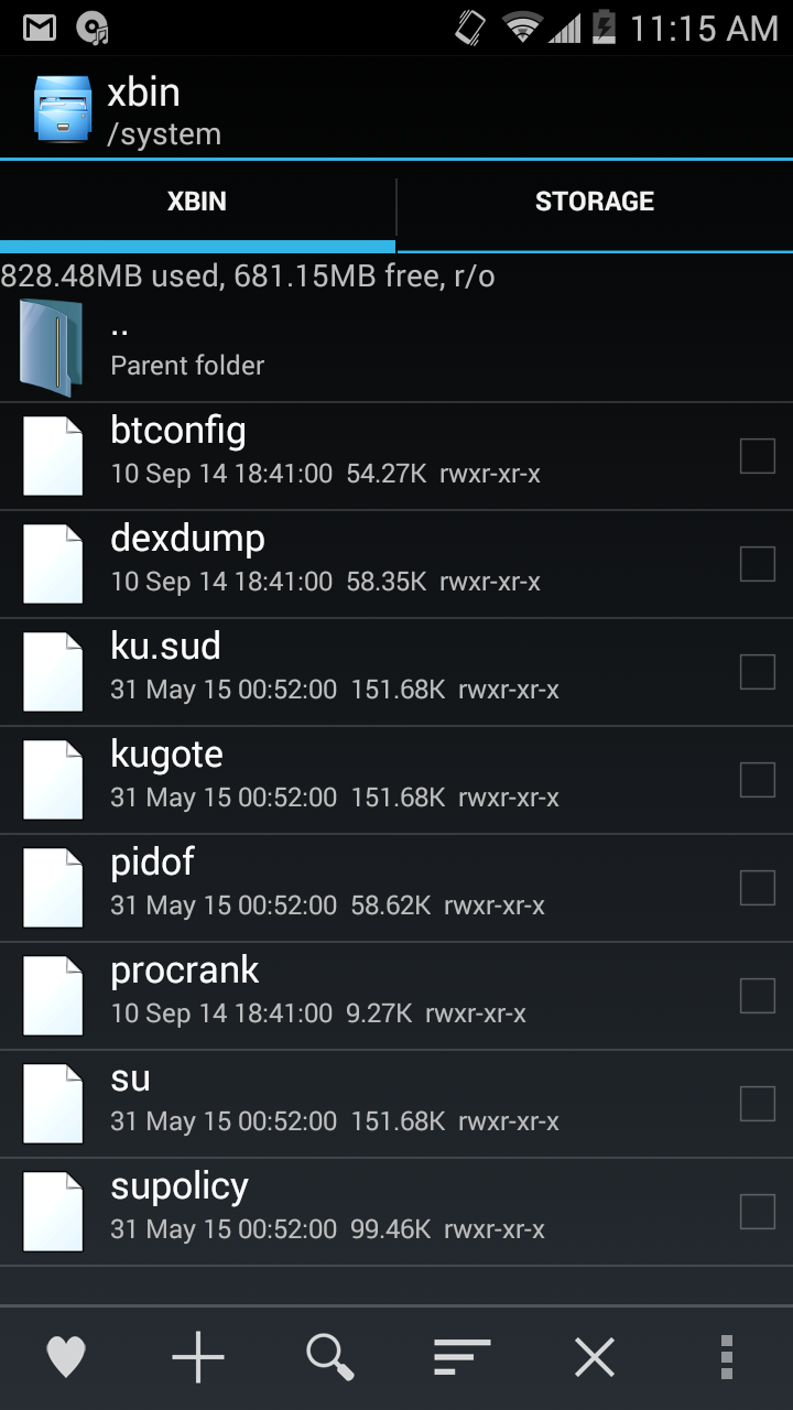

Also, download and install Explorer by SpeedSoftware and navigate to /system/xbin and post a screenshot like this one.
